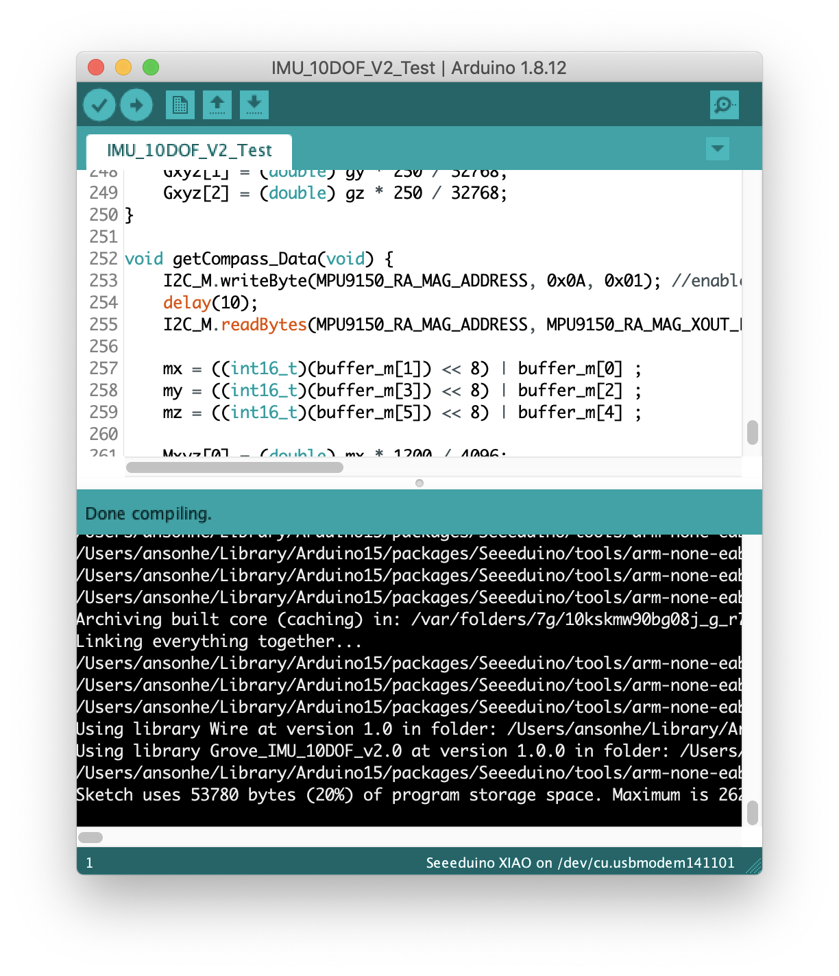

Sorry for the issue caused, can you provide the exact product name for me to check for this.
I have tested compiling this library and compiles OK.
Could you confirm this with the latest stable Arduino 1.8.13 release and confirm the library source code used.
I will try with the same grove library you have confirmed to be compiling.
Thank you.
Okay, please also check your ArduinoSAMD core is up to date to 1.8.0 :smiley:
