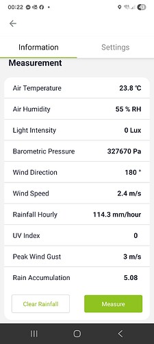

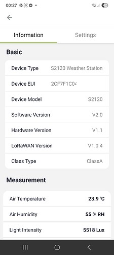

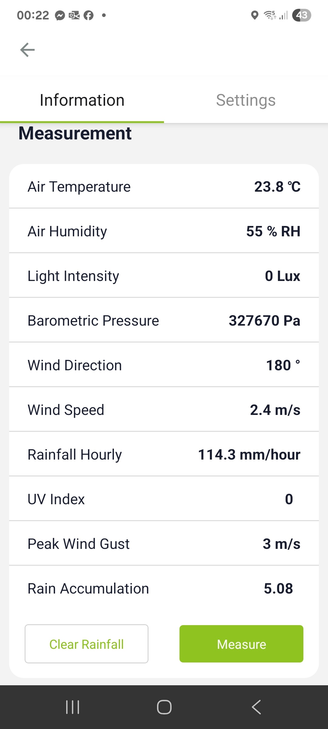

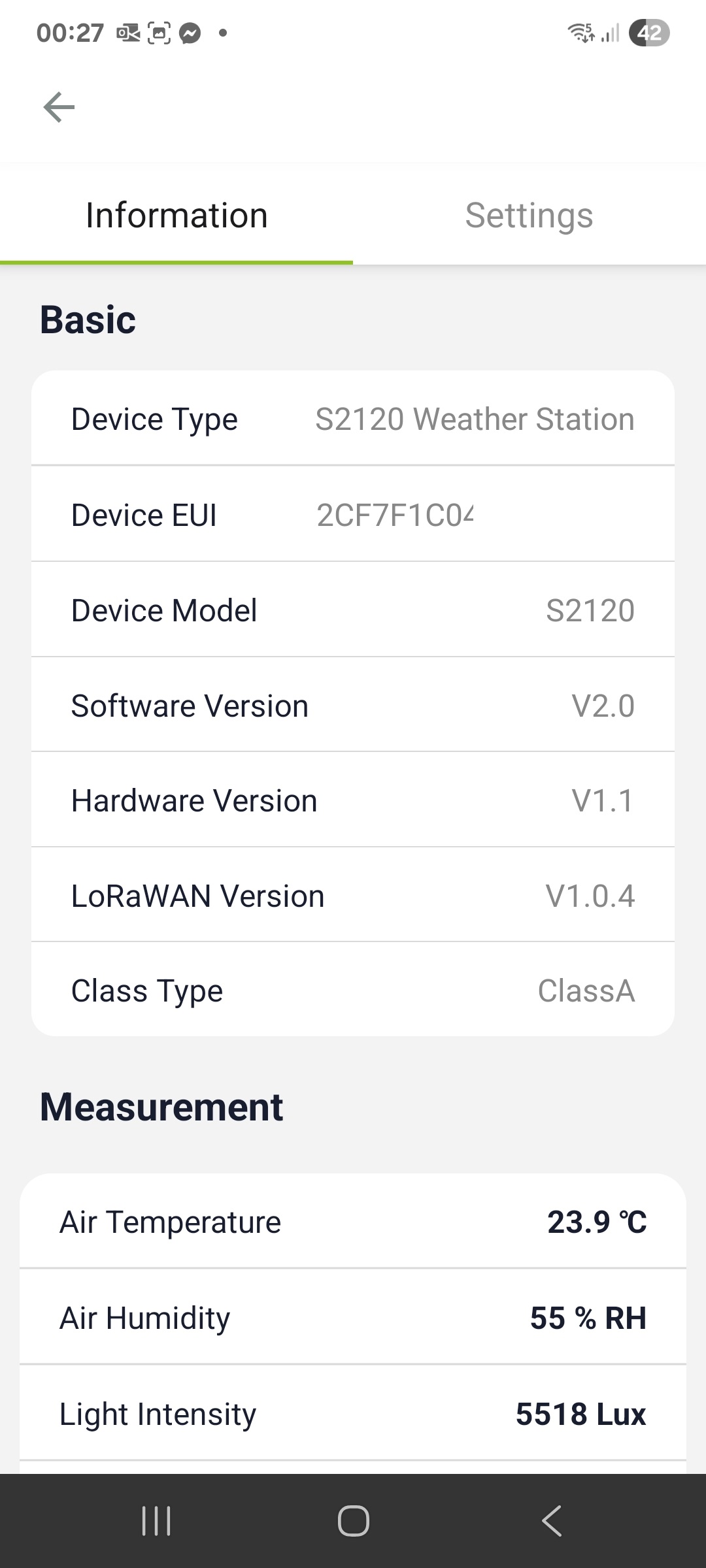

S2120 had very low batteries after about 1,5 year, all three total voltage had about 3,0 V. I changed to new batteries, then I saw that the pressure showed strange value in the phone-app SenseCraft; 327670 Pa. I was running V1.14, and tried the V2.0, but no changes, pressure shows the same. Seems that ALL other values are working and showing normal values. This is when I look in the app, but not yet in Datacake. Have tried V1.14 again, but no luck, so I use V2.0 again, but still the same problem w/pressure. Tried reset, reboot, removed batteries for a day, and opened the unit,checked for corrosion or whatever.

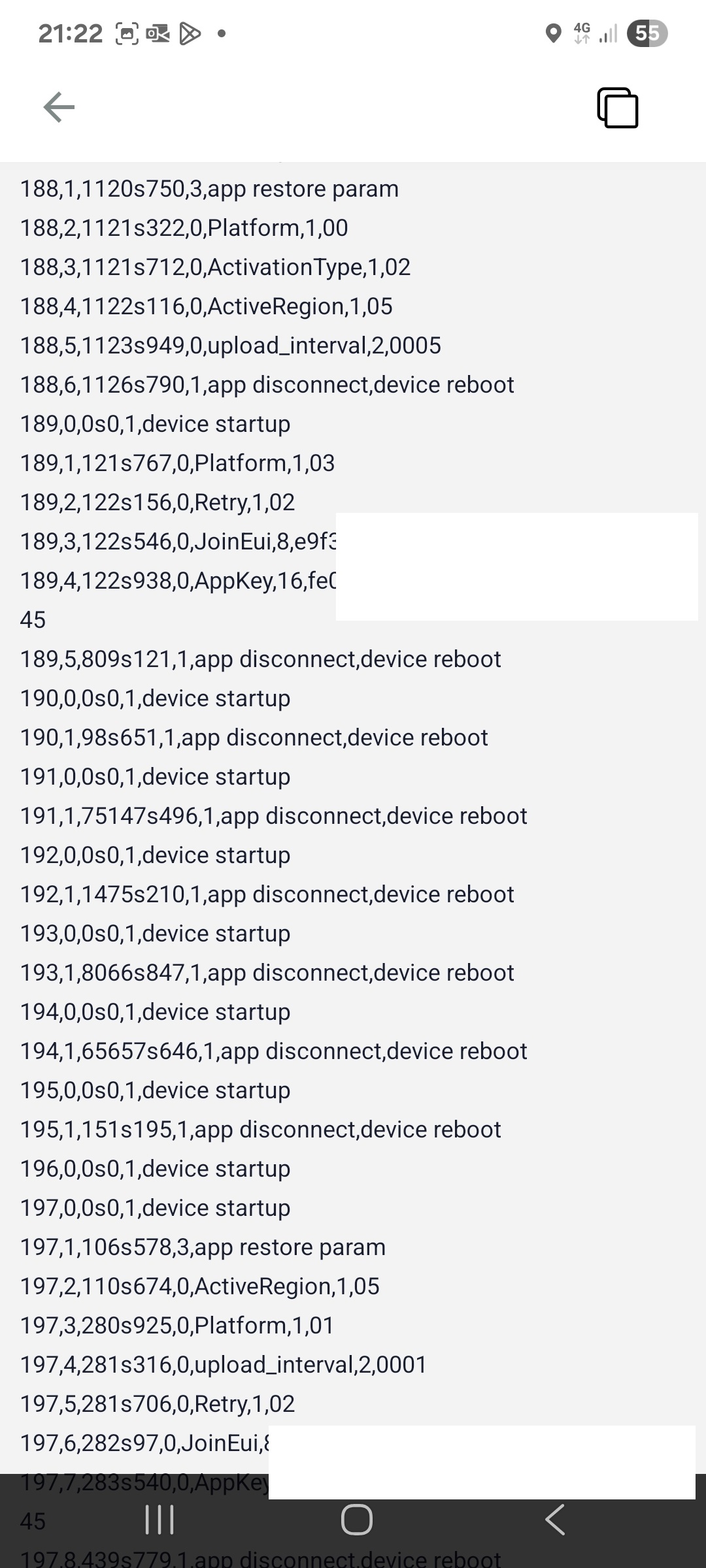

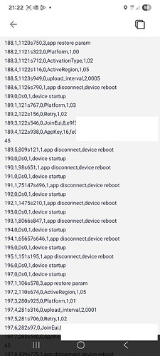

I also found the 15 page log, but did not find any clue there either.One page is shown here. Is it just garbage now…? :disappointed_relieved:

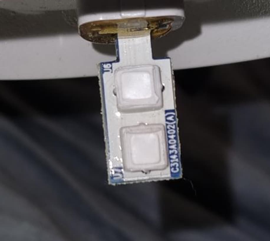

This is the temp/press/hum-sensor. C3143A0402 (A). Could not find so much about it in the net. I would like to buy a new one…:slight_smile:

Within 4 days after chatting with him, I received a new temp/press/hum-sensor. C3143A0402 (A)! Changed it, and everything is back as normal.
