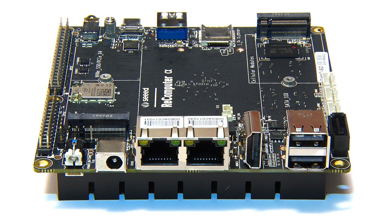

I can run in my little board 4 VM:
  1. pfSense - 1 CPU, 512MiB
  2. Server - 2 CPU, 3GB, Debian 10.3
  3. Voyager - 2 CPU, 2GB, Voyager Linux
  4. Windows - 2 CPU, 2GB, Windows 10
I pass Arduino to Windows machine.
Look at screen shoot:
