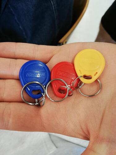

Hello guys, i have an issue.
What is the protocol used for these tags ?
Thanks in advance for your response and have a nice day ! ![]()
it is 125Khz, EM4100 standard. thanks.
Thanks Bill, but is there in GitHub a little piece of code that should be able to decode the data frame and collect the Card Number in the Serie Monitor ?
here is the format.For example as below:
Output: 0700952F229F -------------- -Hexadecimal: Start Bit(07) + Card Number(00952F22)+ Checksum(9F)
then you can covert the card number from hex to dec and add start bit as below. thanks.
Card Number ID: 0009776930 ------- Decimal: Start Bit(00 or other) + Card Number(09776930)
