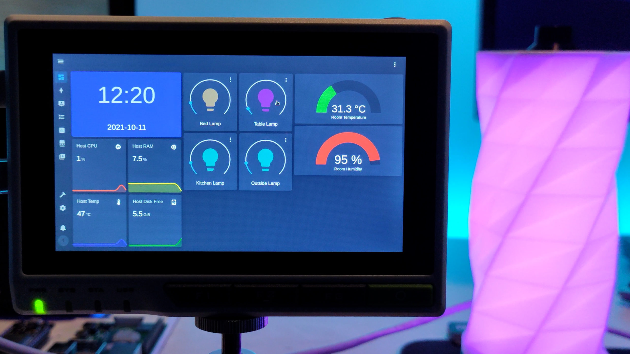

If you want to run Home Assistant on reTerminal, installing OpenWrt only for that job is not a good option. In the blog, I used OpenWrt because I used extra hardware, which is the Dual Gigabit Ethernet Carrier Board for RPi CM4 to run OpenWrt, Docker, Home Assistant, and the reTerminal was only used to visualize the Home Assistant Dashboard.
I would recommend you to use Raspberry Pi OS on the reTerminal and then install Docker on it. After that, you could run Home Assistant as a Docker container on Raspberry Pi OS.
