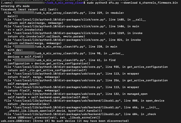

I want to be able to flash the firmwares to switch between 1 channel and 6 channels.
Both product pages points to the same GitHub repo ( GitHub - respeaker/usb_4_mic_array: ReSpeaker 4 Mic Array with builtin VAD, DOA, AEC, Beamforming & NS ). I follow the instructions and I can successfully flash microphone 1 back and forth. However, when I try to flash microphone 2, it doesn’t work.
Here is what I see when I try to flash microphone number 2:
I’ve plugged the device in and out. Rebooted the system. I’ve tried with 2 other ReSpeaker USB Mic Array’s and they all leads to the same issue.
Does anyone know what the problem is? Do I need to do it differently between the two microphones?

The two ReSpeaker microphones look similar but use different internal hardware. The Mic Array v2.0 uses STM32 and supports DFU flashing. The USB Mic Array uses XMOS and cannot use dfu.py. This is why you see the flashing error. Use software channel control instead of flashing firmware. Record or process only one channel using ALSA, PipeWire, or your application.
Do not attempt DFU flashing on the ReSpeaker USB Mic Array. If firmware switching is required, use the Mic Array v2.0.

For the ReSpeaker USB Mic Array, the firmware defines how many channels the device exposes (1 or 6) . With the 6-channel firmware, channel 0 is already processed mono audio. channels 1–4 are raw mic data . Instead of reflashing to 1-channel firmware, you can simply record only channel 0 using ALSA or select that channel inside your application.
If you want true downmixing, you can configure this in PipeWire using a loopback filter module. This creates a virtual mono device that mixes channels automatically.
