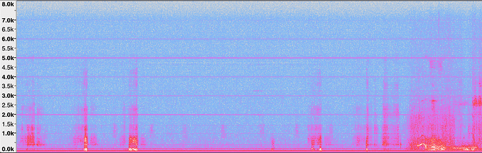

I connected the ReSpeaker Mic Array V2 from the bottom pins to a Raspberry Pi 3B+. All works fine but I notice the recording has an audible noise. See the attached spectrogram: the noise is shown as the horizontal lines as multiples of 1kHz.
If I connect the Mic Array via the micro USB port, the situation is slightly better but it seems to depend on the USB cable. In the end I found a very short USB cable and used to connect the mic array via the micro USB port, the noise disappeared.
I need to connect the Mic Array from the bottom as the micro USB port is in the way. Any suggestions, please?

I have tested the new firmware but the interference noise is still there when using a Raspberry Pi 3B+.
The noise seems to be caused by the Pi as when tested on a Mac computer there is no interference noise.
Any advice on using it with a Raspberry Pi? I have purchased four Mic-Array V2 boards and all have the same issue. Please help.

Please try below instructions. thanks.
  1. change to another usb cable
  2. change to another raspberry pi usb port
  3. change to another raspberry pi
