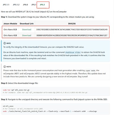

reComputer J3011 (J401 carrier board with Orin Nano 8GB) supported Super configuration now, see J401 Flash Jetpack.
As for reComputer J4012 (J401 + Orin NX 16GB), certain modifications are required for carrier board. There isn’t detailed information regarding the modifications now and we may provide some light customization on J4012 in near future.

So the Super mode came well after theses clones, unfortunately they are NOT capable see note 1 (click the image to read the fine print) :grin:

  • The new super J401 carrier board (with new part number: 202004250) will support Jetson Orin Nano and Orin NX with super mode configurations.
  • The previous J401 carrier board (SKU: 102110770), used by reComputer J3011/J3010/J4011/J4012 does not support MAXN super mode on Jetson Orin NX modules. It support Jetson Orin Nano with super mode configurations and we have already released the JetPack 6.2

Can the old “classic” J4012 reComputers run Jetpack 6.2? I realize Super Mode could be problematic from a power and heat dissipation standpoint, but what if super mode is not used? I just want to be clear on whether JP6.2 is an option for this hardware, or if we have to stick with JP6.1.
The short ANSWER is NO.
the J4012 and the J4011 are NOT updated to the JP6.2 due to the instability introduced with “SUPER mode” the Higher current draw and temperatures effects the stability in most use cases.
the 6.2 was intended to address the other models.
It was stated in NOTE 1 of the compatibility grid also.(fine print)
