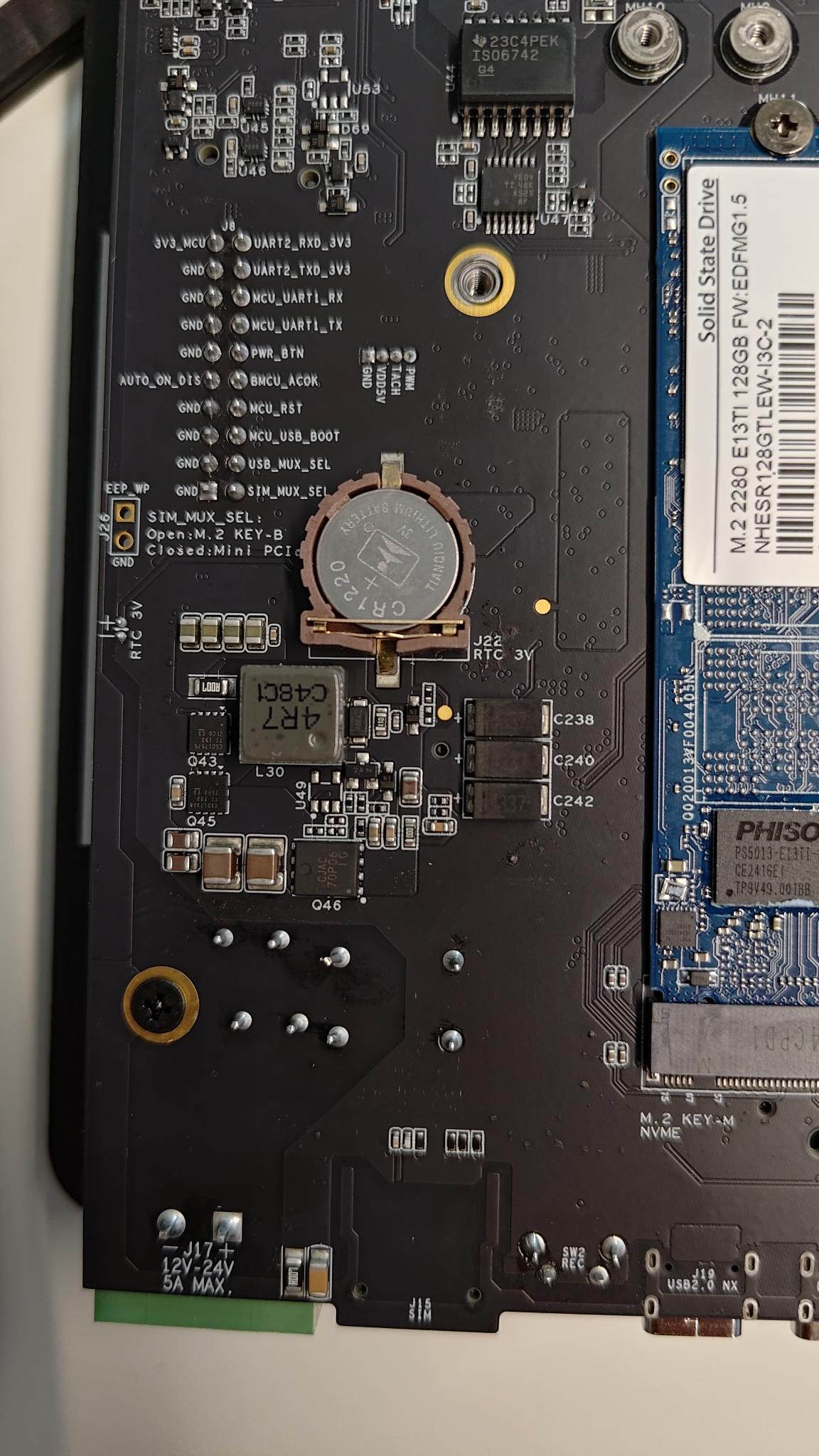

Hi @Seeed_Seraphina, the RTC battery comes with the device, we’ve found it already installed here:
You can see the coin cell battery in the center, with the tag RTC next to it.
Okay, let’s buy the same RTC battery and try it out. :smiling_face:
