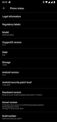

I’m using Android 8.1:
[attachment=0]Screenshot_20180602-201018.jpg[/attachment]
