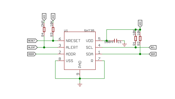

Regarding part number 101020592, could you please confirm whether a 10 kΩ pull-up resistor is already included in the circuit?
The customer would like to know whether any additional pull-up resistor is required when interfacing this module with other equipment.
Thank you for your assistance.

According to the schematic, the 10k resistors are included on the I2C lines, as well as Alert and Reset.
