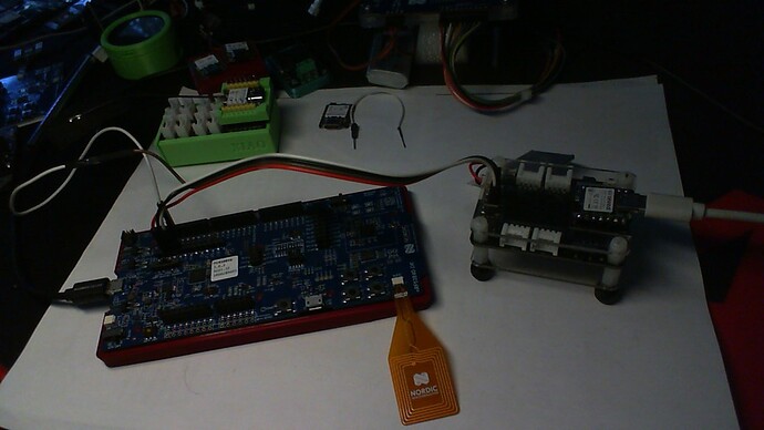

SO , you can definitely do it, I have a posts or two on it with Pictures and setting used. You can use the NRF_connect Programmer connected to DK as well :+1: SWD from Xiao DEV board to DK and the VDD connection makes it go. :v:
You can tell which is the Target from the NRF_SDK hardware connection will show the Device REV xx check it out works GREAT!
