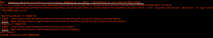

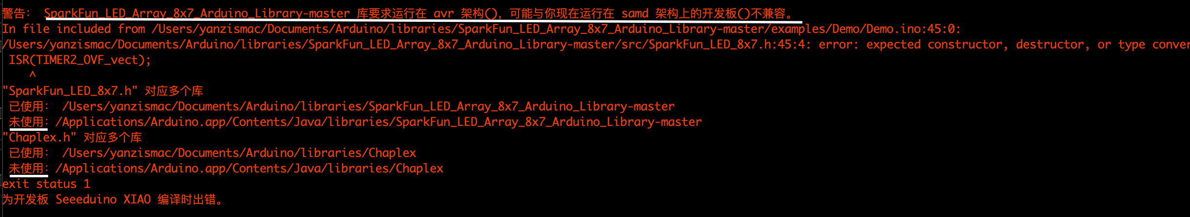

This is a problem I encountered when compiling with XIAO
Text display,part of the sparkfun 7 * 8 LED library is not compatible
Is there any way to solve this problem?

From the sparkfun/ LED_Array_8x7 Github repo, it says
the library supports any ATmega 328-based Arduino.

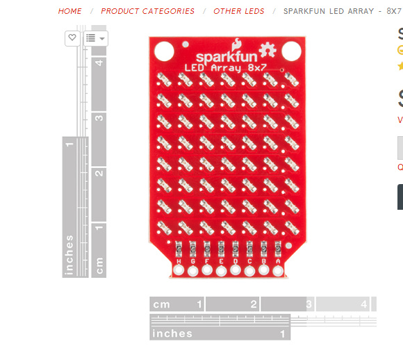

and XIAO is based on ATSAMD21G18A-MU based on one. and can you share what kind of display you are using, I try to find lib that compatible with XIAO.

The LED module I use is sparkfun_7*8_led
like this!
@salman i just wanna to show some diy bitpictures(triggered by a condition) ![]()
