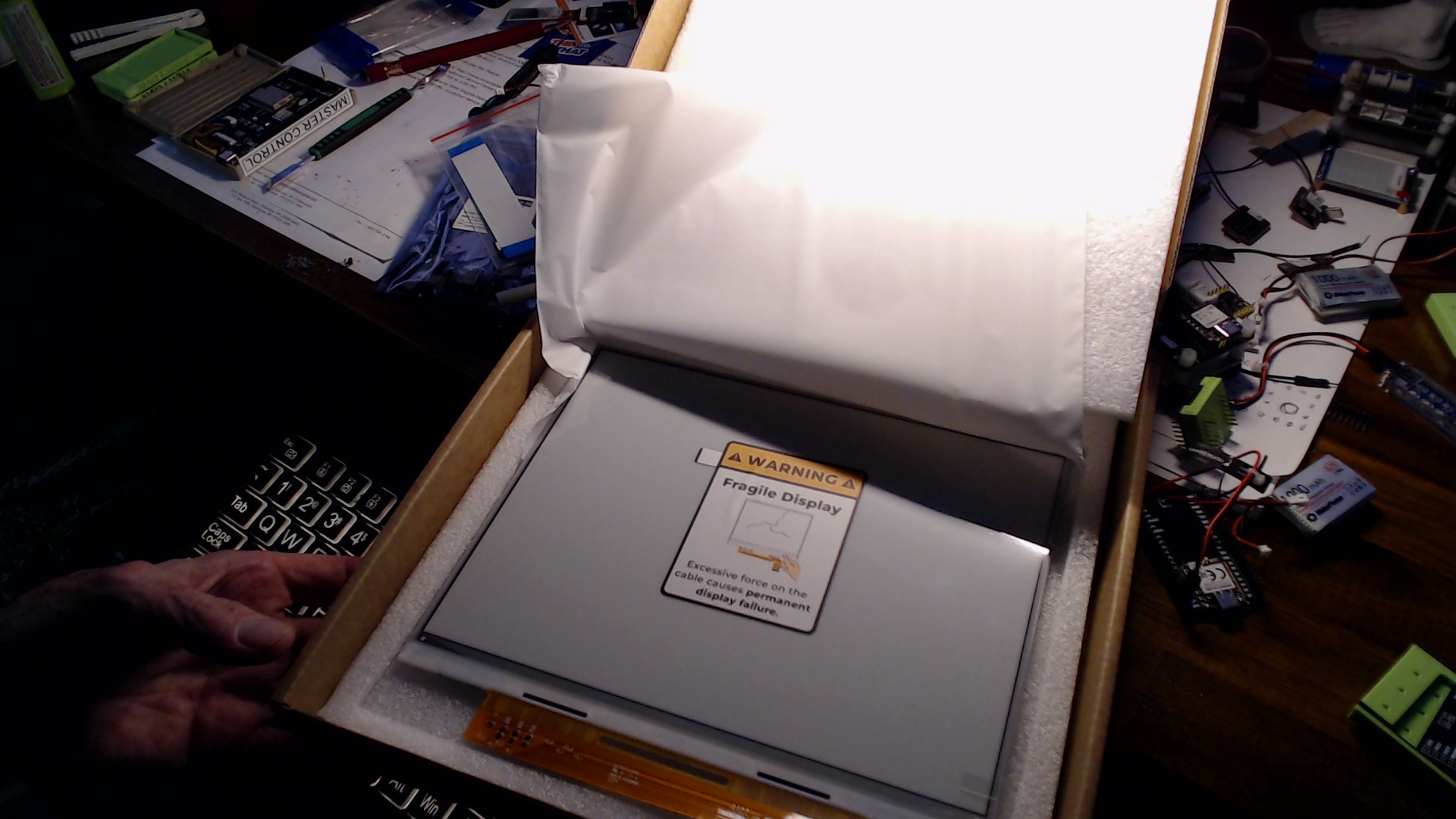

You see on discord they are working through issue’s with the larger displays. I just received the E1003 DIY kit, I won in LIVE stream. with the 10.5" monochrome. :heart_eyes:
