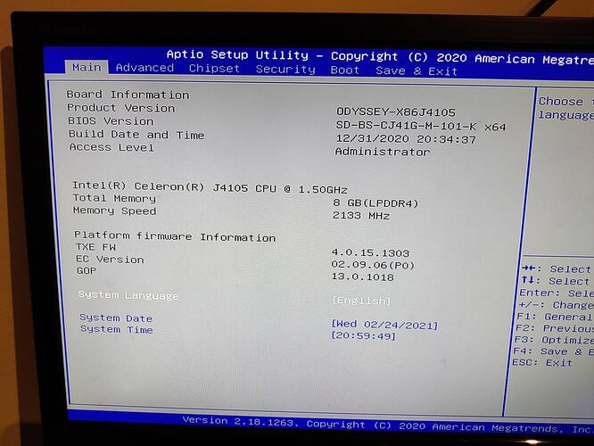

Pls shoot a picture of the BIOS screen. You can remove all power then retry.
Here is a BIOS screenshoot, hope it helps to identify the problem

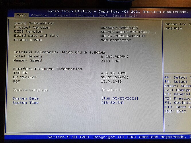

attached is picture of the new bios
Thanks in advance
Dario
