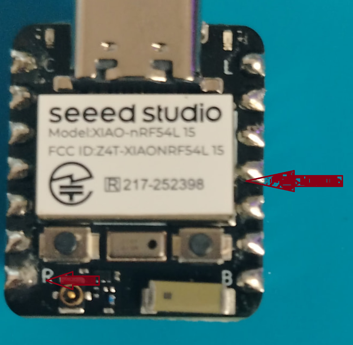

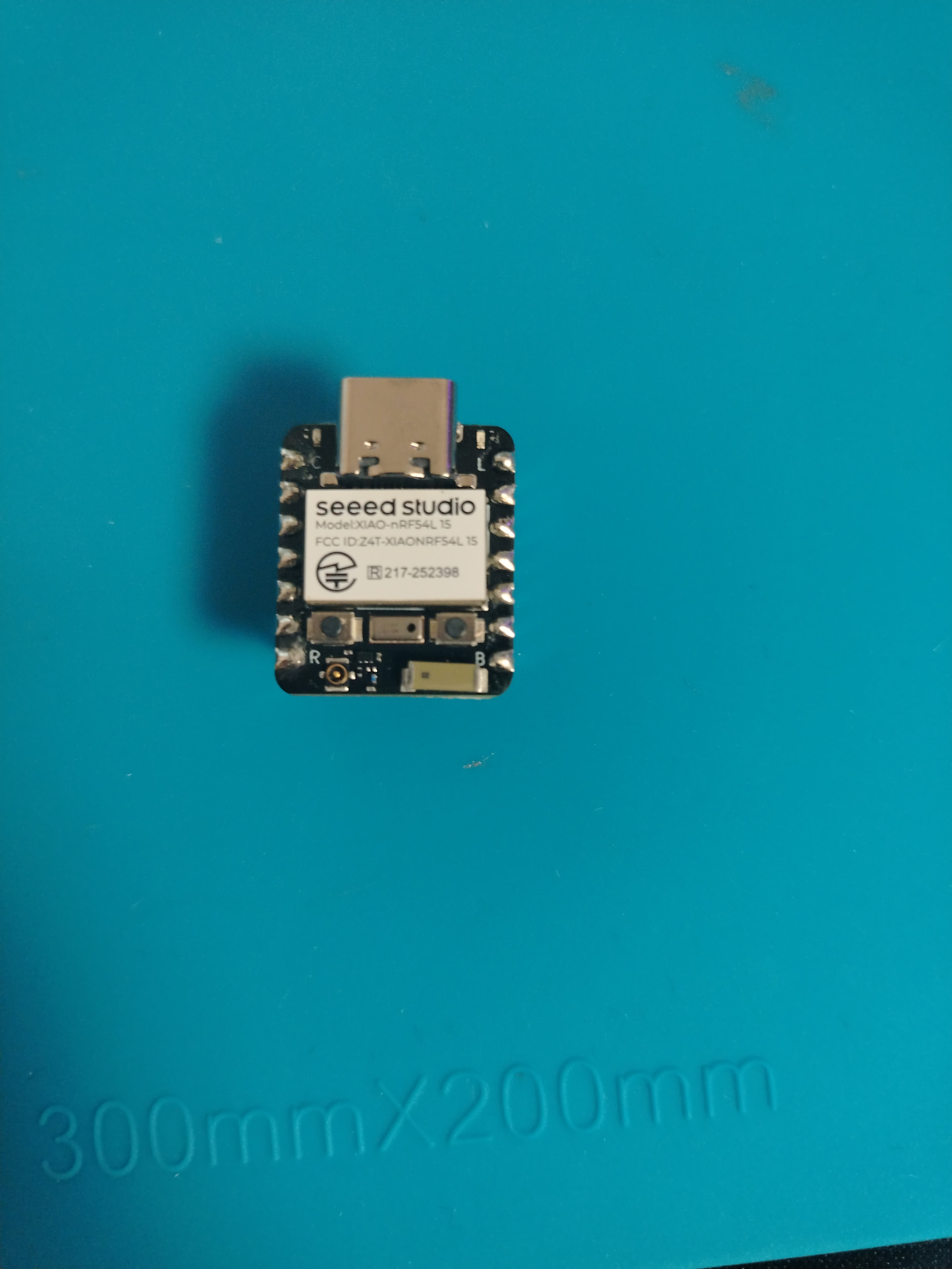

Sounds like a power supply or battery issue, How are they powered?, You take any readings
You have a picture ?
The same USB!
And I don’t understand what the problem is…
So, can I ask who solderd this? You or Seeed ?
Can you reflow the pins and clean up a little, less solder more flux BTW :+1:
Try again.
Seeed!
I only flashed it! I haven’t soldered it yet! I returned the board.
Ok, then , WOW …
Something was up … that was probably the worst looking Xiao I have ever seen.
if you still had the package , maybe they could check the batch, that day someone was lacking no doubt. (Chinese new year and all) :wink:
Glad you returned it.
They are IMO the best MCU 's on the planet :+1:
I’m guessing it’s the fault of the sellers who soldered the legs to the board, not the SEEEDs themselves. =)
ah’ I didn’t know that was a thing…Yikes :speak_no_evil_monkey:
