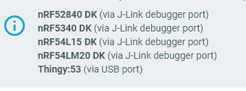

Nice but does it work with XIAO nRF54L15 board or only Nordic DKs?
I won’t spoiler it for you… :grin: :+1:

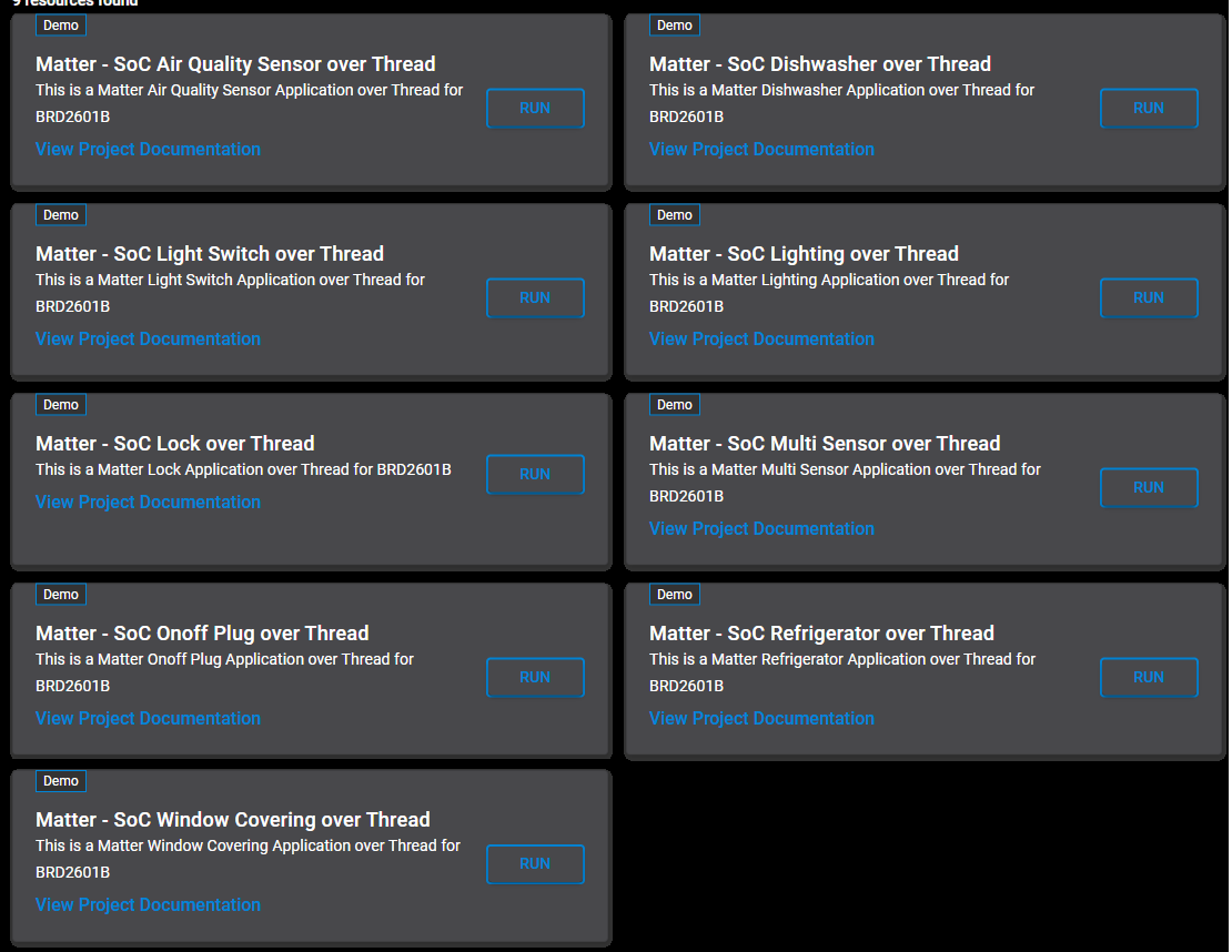

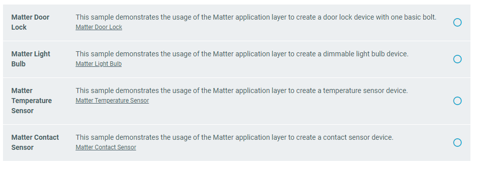

Kinda “small” at the moment… only a few “examples” to “Quick Start” with…
… and on limited devices…

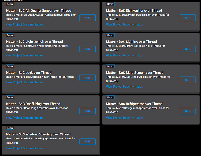

Compared to MG24’s “Demo’s” (also limited to “known” devices - excludes XIAO!) …
