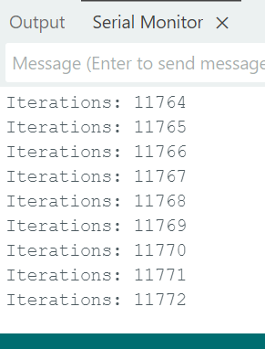

In both cases, the board will run until it hits exactly 11772 iterations and then it quits (see below for serial output at the moment it stops working). This number of 11772 is true for both programs above, and with the sine-wave alarm it’s of course reached faster because the individual tones are much shorter.

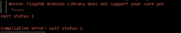

Thanks for the response. I did install the library and included the relevant header but it doesn’t support the nRF52840 core yet:
