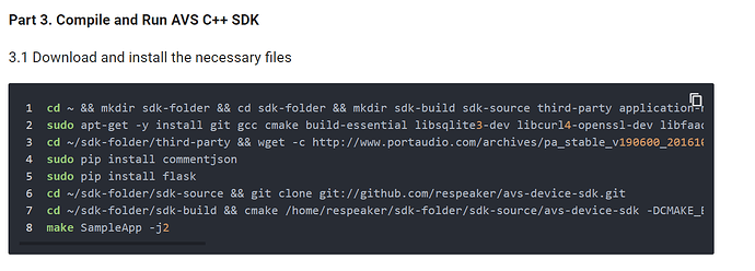

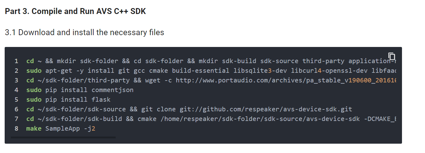

I have a respeaker core v.2. I have successfully followed the preparation steps and out of box demo. I was able to burn the image onto the SD card (16GB) and connect to WiFi. I am able to follow all of the steps up until this point
As I run the last command shown here ^^ I get an error that says there is not enough disk space. Error shown below
fatal error: error writing to /tmp/cce8hVfG.s: No space lef on device
