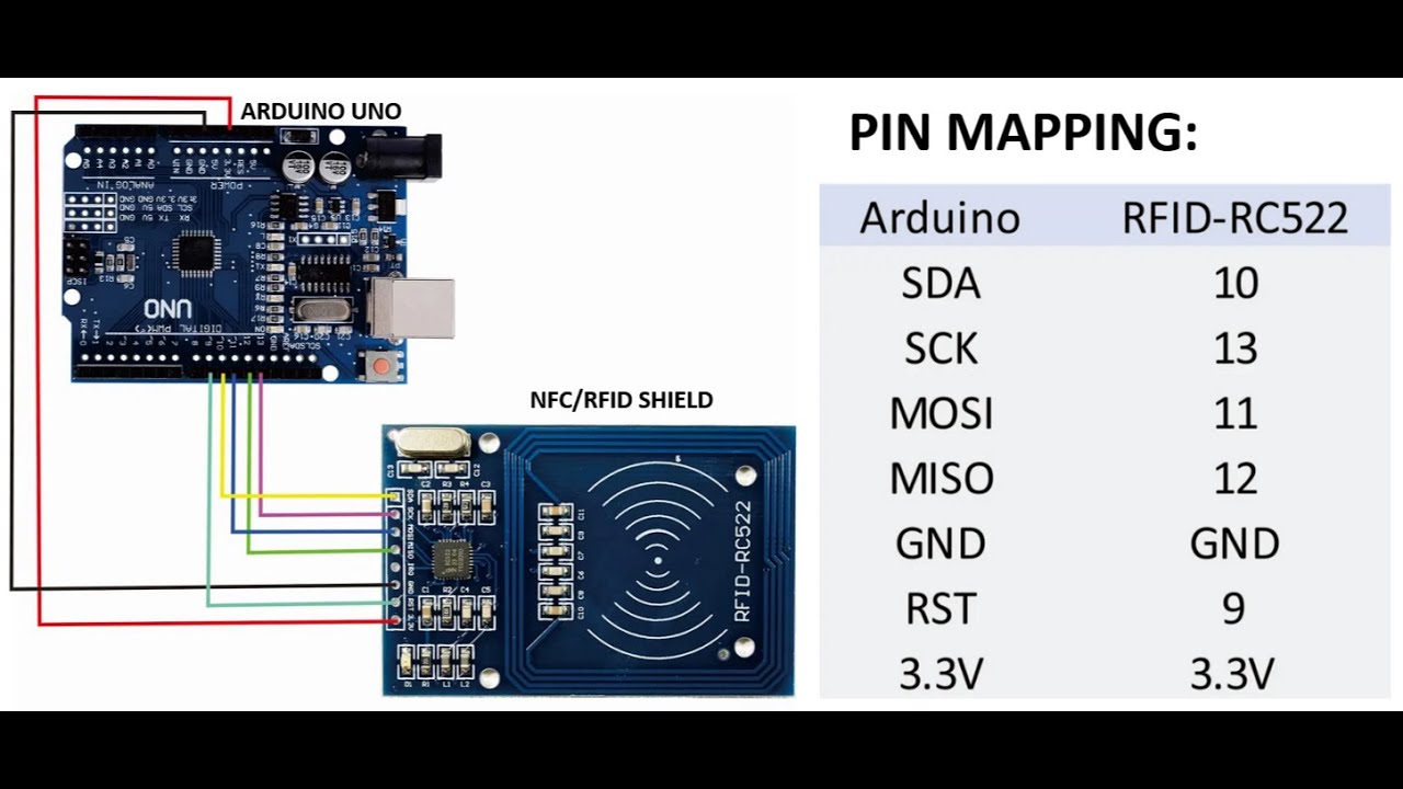

So there are a ton of examples of doing the NFC with Arduino?
here is a link to one:
