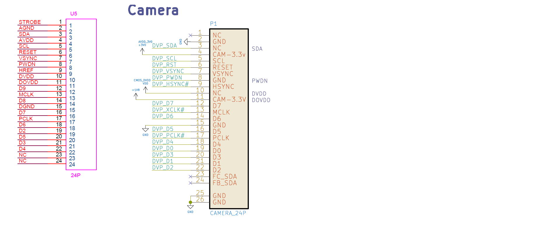

I purchased OV5640 camera with different lens to change in Maixdunio, but it is not working. The schematic of the camera pins in the Maixdunio is unclear, what is the correct connection? please look at new camera (U5) and Maixdunio drawing, where is the SDA connected in the board? can you detect why the new module does not work?!
