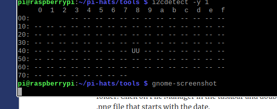

I’m trying to get a 4 channel 16 bit ADC (<LINK_TEXT text=“https://www.seeedstudio.com/4-Channel-1 … -2829.html”>https://www.seeedstudio.com/4-Channel-16-Bit-ADC-for-Raspberry-Pi-ADS1115-p-2829.html</LINK_TEXT>) working on a Raspberry Pi 4.
I went through the wiki and everything works as far as the install and the ads1115.sh script in pi-hats.
My problem is getting some C code to interface with it. For example, this code fails at the test on line 26…
</s>ioctl(fd, I2C_SLAVE, ads_address) < 0<e>
