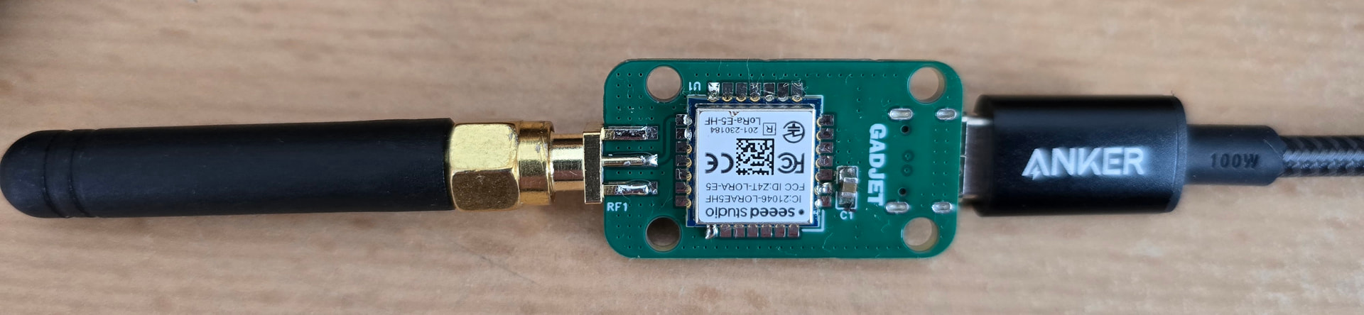

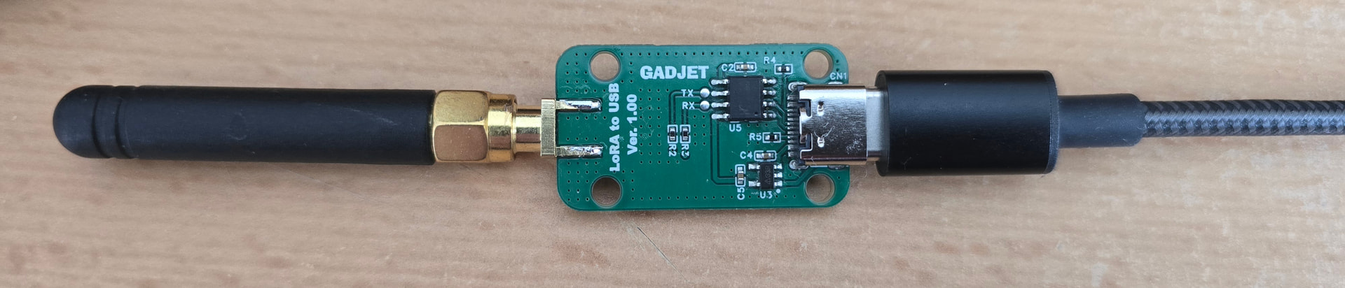

As an offshoot from an earlier project with a xiao ESP32 module to a WIO-E5 I thought about making a USB to WIO-E5/antenna adapter.

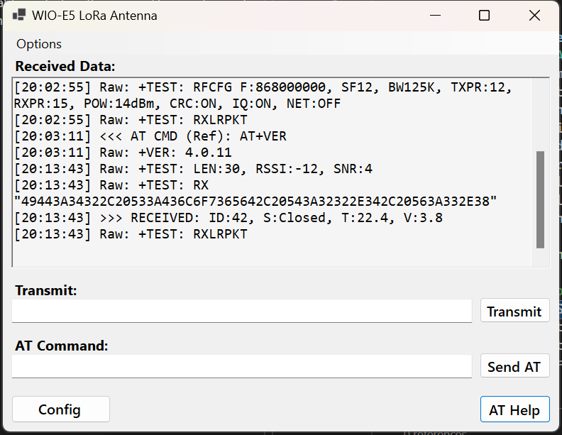

This allows you to connect a Wio-E5 module to a PC/Phone/Raspberry Pi and send/receive data directly. With the help of Gemini I also created a PC App to interface with the USB - E5 adapter.

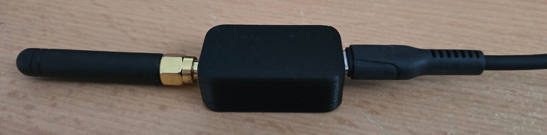

Time for a smooth 3D printed Case Too! :wink: :crossed_fingers:

Thanks, yes a case in currently in process in fusion360, print it out later tonight :slight_smile:

Case designed and printed.
