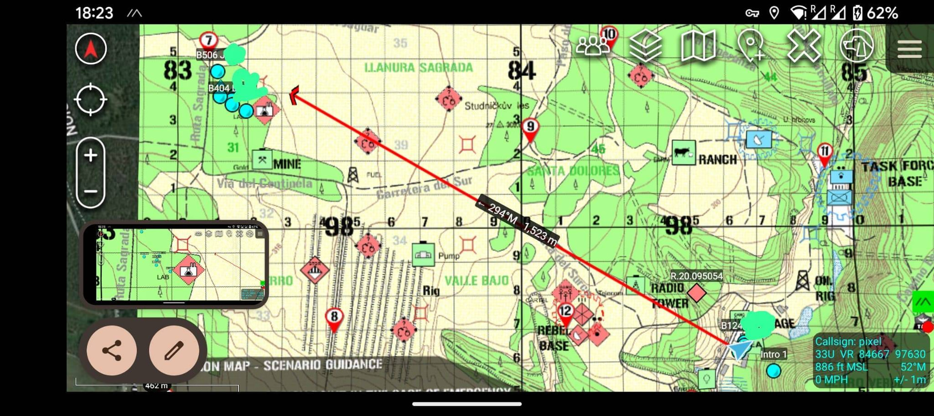

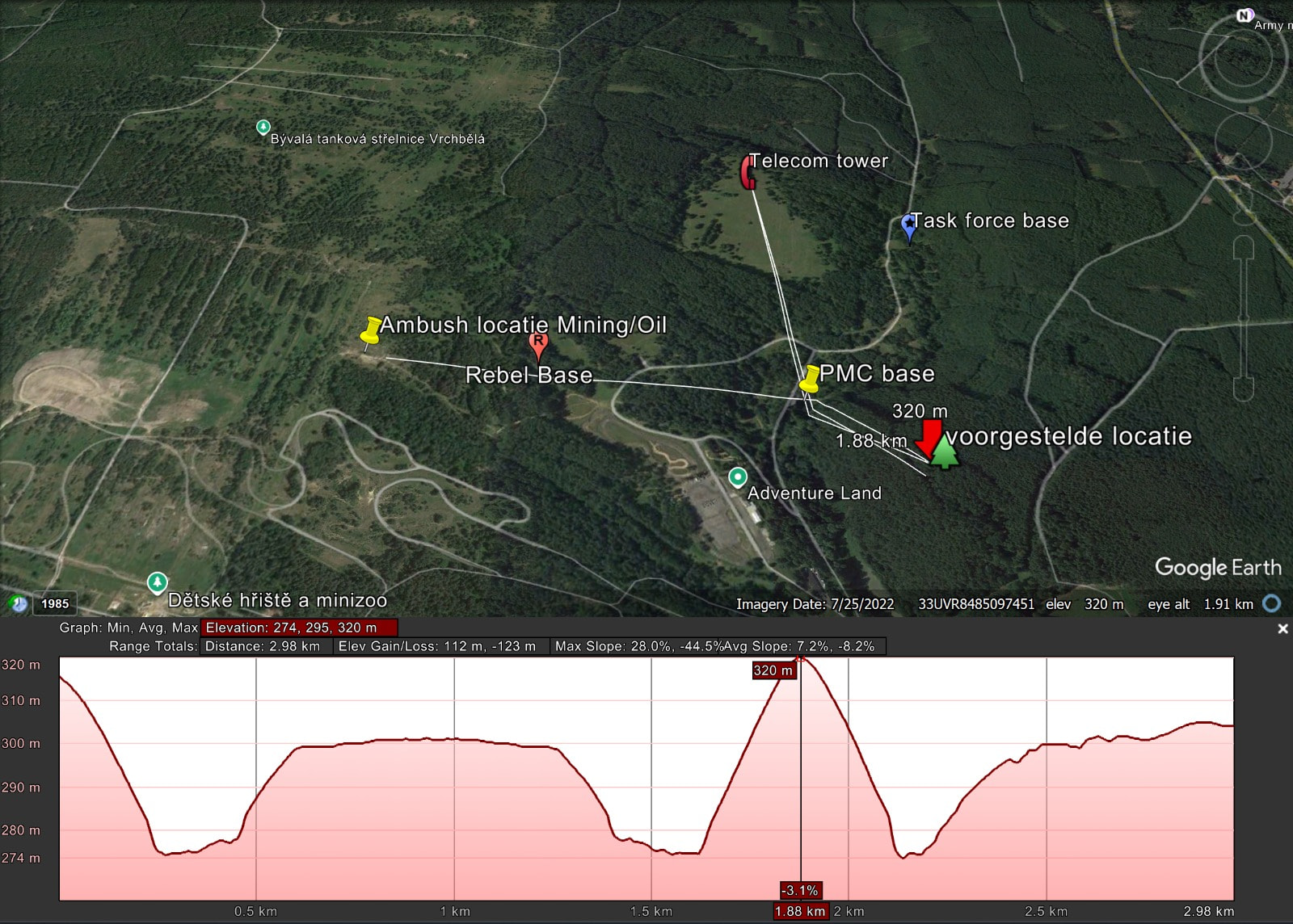

I am currently in the market for a few meshtastic trackers that are pre-made (made Heltec 114 trackers before, but it was quite finicky for the airsoft team). And was wondering if the L1 Pro trackers have known performance metrics in forests.
The use-case would be that the airsoft squad would carry trackers on person (some with phone some without). And that nearby the base one of the trackers would get slung up a tree to act as a relay (still in client mode).
Would also love to know what battery life I can expect out of them when they are put into semi active movement.
Picture is of the terrain with mesthastic nodes (114 boards) in ATAK using the meshtastic TAK plugin.
In short: Would love to know the range/battery expectations for a L1 pro. pictured elevation profile where the highest point would be the relay
Many thanks for reading and in advance

Cheers thanks for your reply, yeah I got the relay tracker up in a tree for that. Reason being we are going for the lt1 instead of the t1000 is the better battery life and easier flashing. Saves is carrying another cable we can forget.
Maybe I should look at a whip antenna at the same time since vertical difference is not that much.
