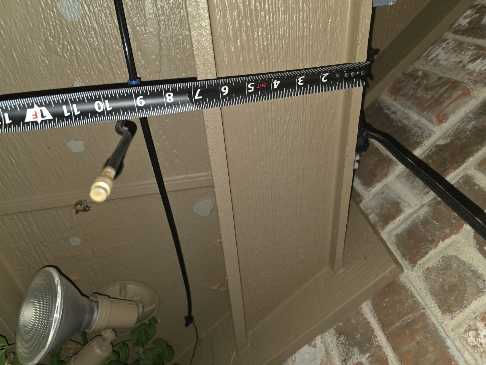

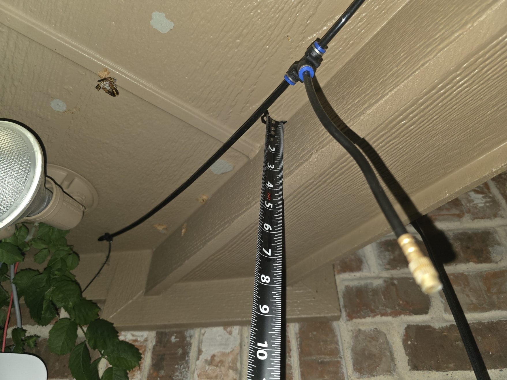

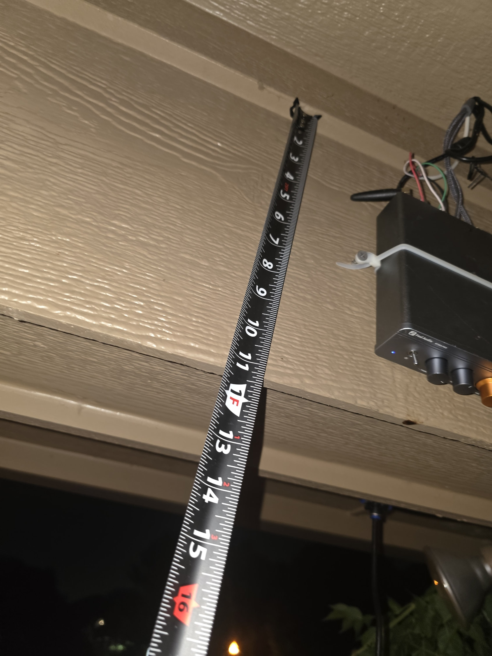

My installation would benefit from placing the microphone array on the front of a covered patio beam while keeping the XVF3800/XIAO electronics protected on the rear side of the beam. I may need approximately 30–40 cm (12–16 inches) of cable to do this cleanly.
