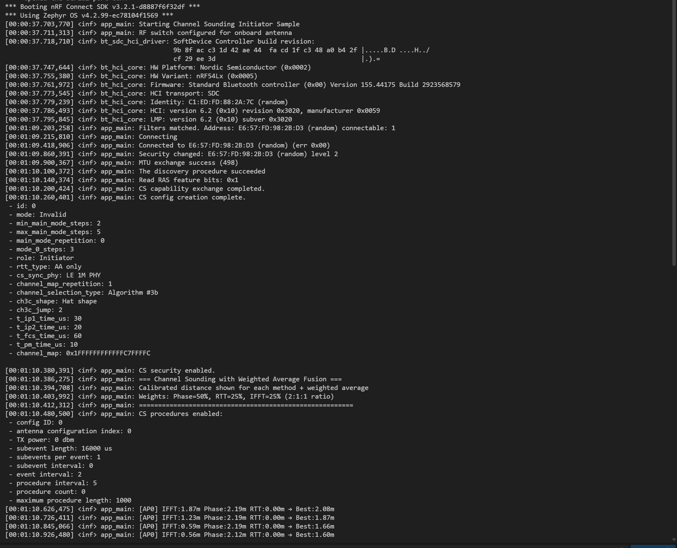

This is what I get when I run my modified versions of the samples against sdk 3.2.1.
those are valid distances.

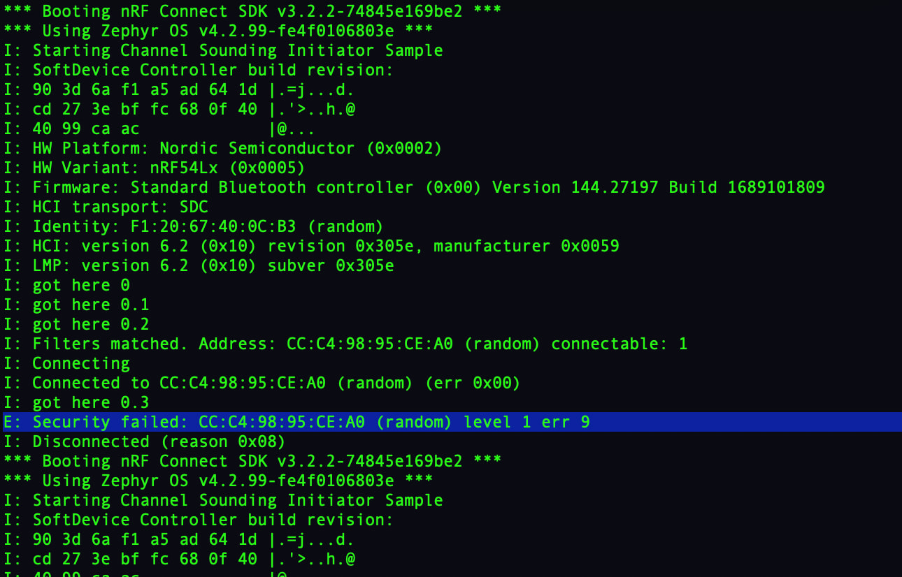

Ok, let me fully digest what you have here. Just a quick (odd) update/detour on my side. When I moved back to the reflector to just see what it was doing/saying it was acting dead. TLDR: I oddly couln’t talk to it until I tried flipping it over (instantly worked) on the usb c cable to the mac. First time for that for me.
Anyway, I have them both now flashed, talking and on the mac and now I get an interesting security pairing error which is actually a good thing. They are trying to talk now. I’ll see if your info helps me resolve that, thanks!!!

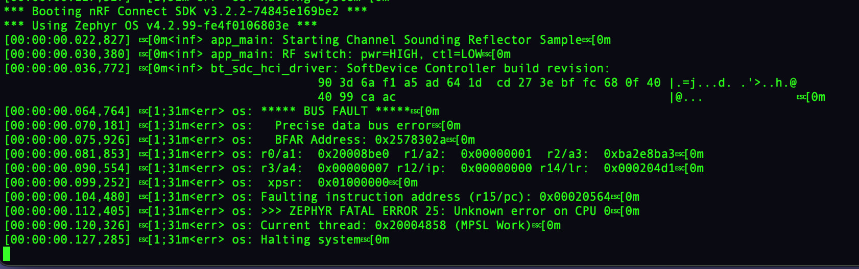

Ok, I just tried your latest commit. The good news, both reflector and initiator built cleanly with zero effort, just flashed and started. Also the initiator boots and waits similar to my connection waiting before with the vanilla nordic code.
The bad news, I get an error on the reflector (with or without the initiator powered up). It’s a one and done error due to halting which is nice (unlike the earlier infinite loops).
Not sure why some chars seem off a bit? But I assume it’s 115200 since it looks generally very clear.

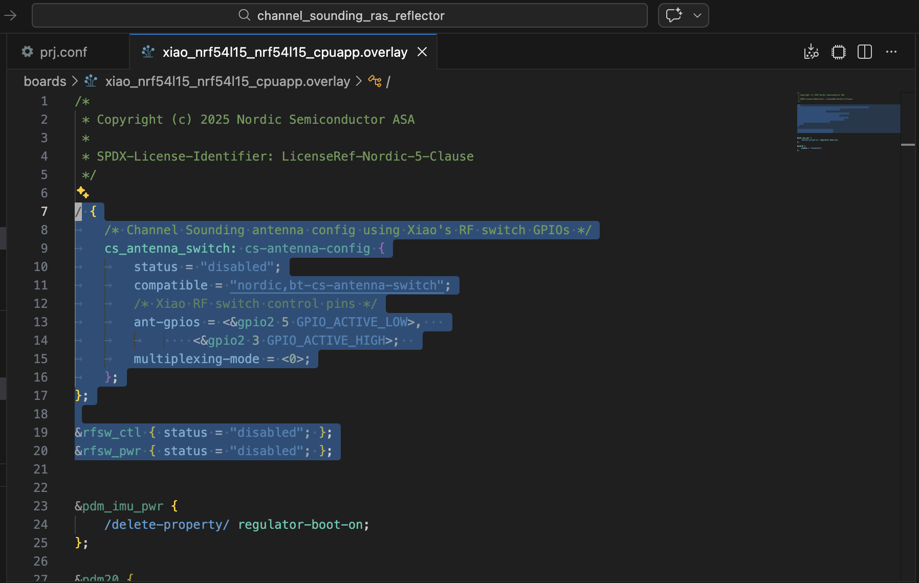

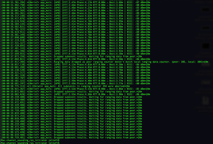

Ah, so I got it to work after removing those two gpio mentioned in the device tree overlay for rf switch control. ??
Let me play around with it, but already I saw some cool distance measuring!! (see below)
Thanks soooo much for all your help Toastee0!!!
Can you try again please?
If I put back the original overlay file, it builds and when I flash I get the instant bus fault
jeltoftMBP:VScode jeltoft$ monr
--- Terminal on /dev/cu.usbmodem72CC059D3 | 115200 8-N-1
--- Available filters and text transformations: debug, default, direct, hexlify, log2file, nocontrol, printable, send_on_enter, time
--- More details at https://bit.ly/pio-monitor-filters
--- Quit: Ctrl+C | Menu: Ctrl+T | Help: Ctrl+T followed by Ctrl+H
*** Booting nRF Connect SDK v3.2.2-74845e169be2 ***
*** Using Zephyr OS v4.2.99-fe4f0106803e ***
[00:00:00.022,829] ␛[0m<inf> app_main: Starting Channel Sounding Reflector Sample␛[0m
[00:00:00.030,382] ␛[0m<inf> app_main: RF switch: pwr=HIGH, ctl=LOW␛[0m
[00:00:00.036,773] ␛[0m<inf> bt_sdc_hci_driver: SoftDevice Controller build revision:
                                            90 3d 6a f1 a5 ad 64 1d  cd 27 3e bf fc 68 0f 40 |.=j...d. .'>..h.@
                                            40 99 ca ac                                      |@...             ␛[0m
[00:00:00.064,759] ␛[1;31m<err> os: ***** BUS FAULT *****␛[0m
[00:00:00.070,174] ␛[1;31m<err> os:   Precise data bus error␛[0m
[00:00:00.075,918] ␛[1;31m<err> os:   BFAR Address: 0x2578302a␛[0m
[00:00:00.081,842] ␛[1;31m<err> os: r0/a1:  0x20008760  r1/a2:  0x00000001  r2/a3:  0xba2e8ba3␛[0m
[00:00:00.090,541] ␛[1;31m<err> os: r3/a4:  0x00000007 r12/ip:  0x00000000 r14/lr:  0x000204d1␛[0m
[00:00:00.099,236] ␛[1;31m<err> os:  xpsr:  0x01000000␛[0m
[00:00:00.104,460] ␛[1;31m<err> os: Faulting instruction address (r15/pc): 0x00020564␛[0m
[00:00:00.112,381] ␛[1;31m<err> os: >>> ZEPHYR FATAL ERROR 25: Unknown error on CPU 0␛[0m
[00:00:00.120,299] ␛[1;31m<err> os: Current thread: 0x20004858 (MPSL Work)␛[0m
[00:00:00.127,258] ␛[1;31m<err> os: Halting system␛[0m
I don’t think your actually need to specify the RF switch and antenna pins in the overlay. Should be safe to remove that section unless you want to use the external antenna port.
Sure, sg!
I was only doing that because of what I think was a question to confirm if that was my actual issue in the comment just before that. Or maybe I read that incorrectly?

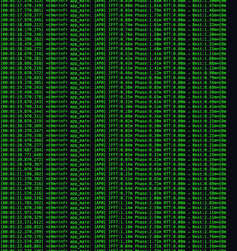

@Toastee0 quick question. Do you know if RTT has ever been validated with these two examples for initiator and reflector?
In my testing, I’ve noticed that RTT is basically always 0.00m. Sometimes it’s a few centimeters but I think that’s just noise? The IFFT and PBR seem pretty good, and I’ve also added RSSI just to see what it looked like.
Round trip time(RTT) usually RTT works ok, but often returns 0, which is why I ignore it when it hands 0’s out. the updated sample i made had a feature that should ignore rtt when it’s 0 and provide a weighted estimate off the other data
