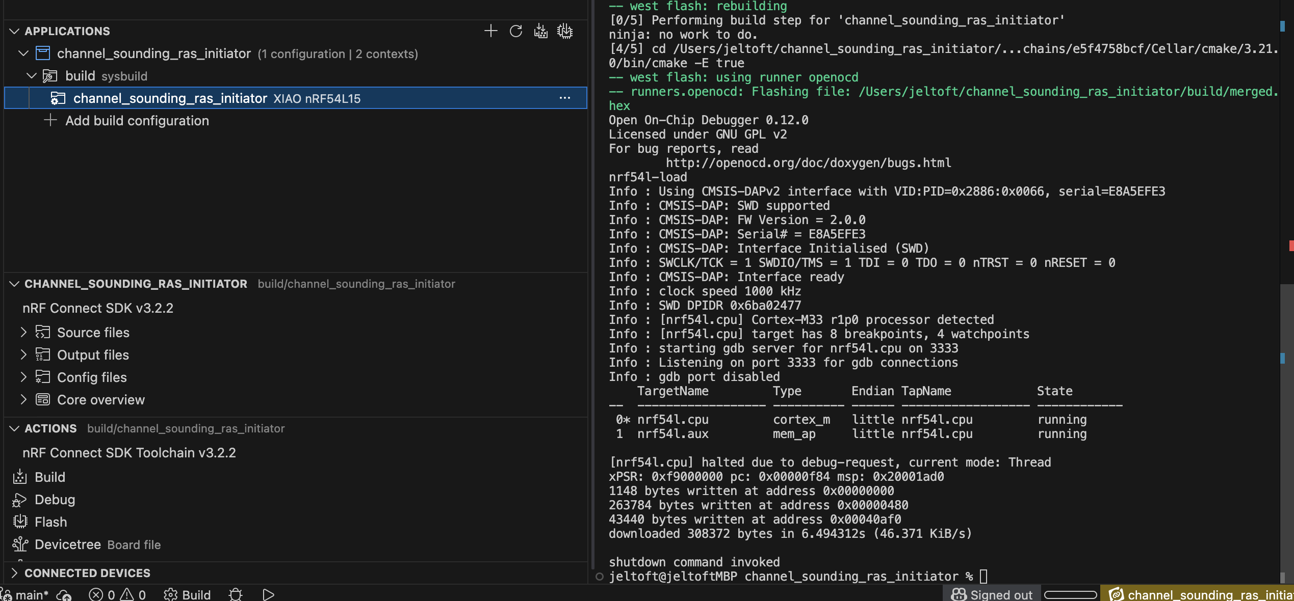

jeltoft@jeltoftMBP build_1 % west flash
-- west flash: rebuilding
[0/5] Performing build step for 'blinky'
ninja: no work to do.
[4/5] cd /Users/jeltoft/blinky/build_1/_sysbuild &...s/e5f4758bcf/Cellar/cmake/3.21.0/bin/cmake -E true
-- west flash: using runner openocd
FATAL ERROR: elftools missing; please "pip3 install elftools"

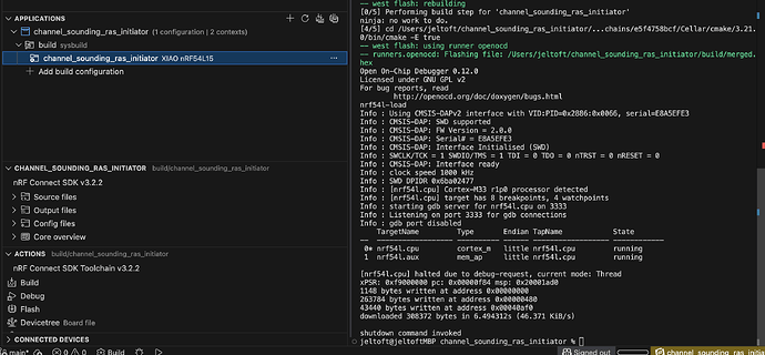

Make sure to open the NRF terminal by right clicking on your application in the list in vs code on the left and choosing open NRF terminal it will open with the correct python dependencies

I was able to get vscode to fully compile for the ras initiator script. :partying_face: Thanks again for the advice to use vscode for this bleeding edge.

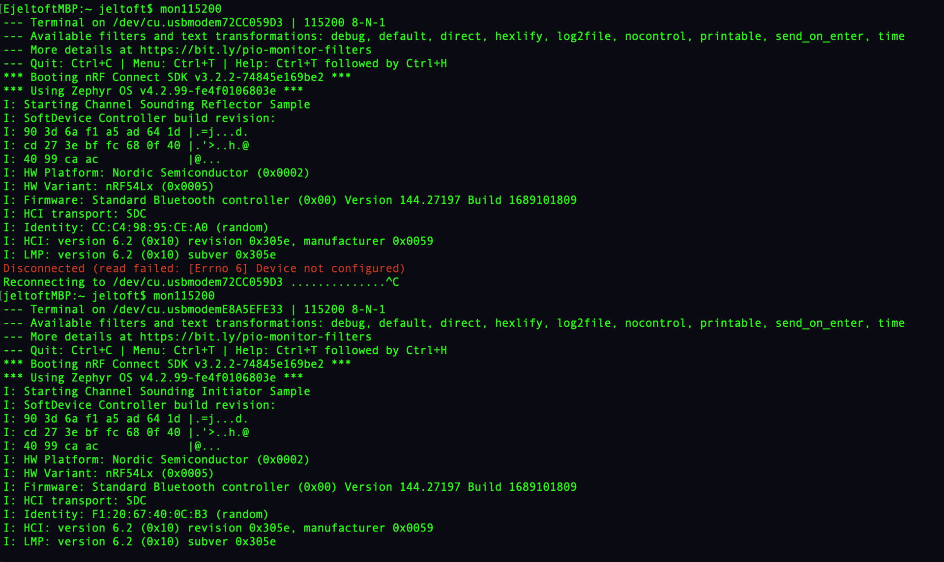

I’ll have to flash up the reflector in a second xiao now to see how it goes. The boot up looks promising though!

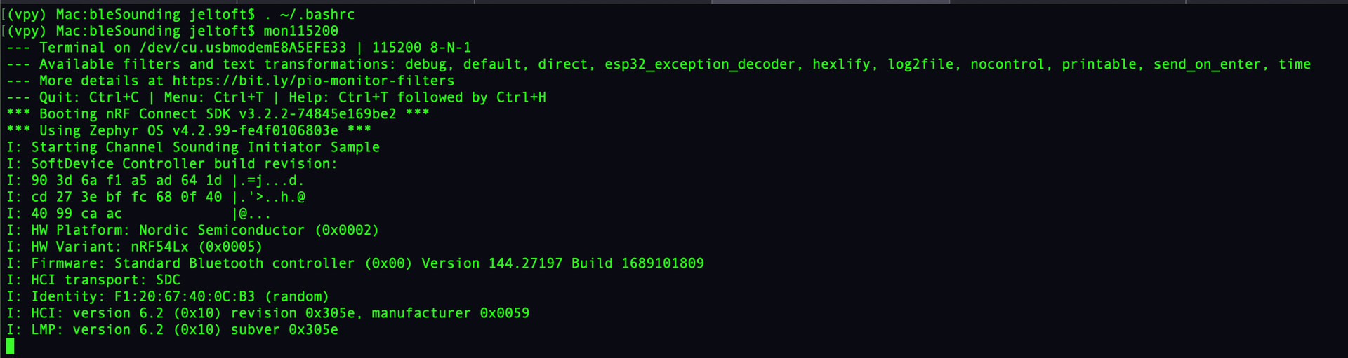

A quick update. Mostly success, I have both the reflector and initiator running now. I did have to increase the heap for the reflector to successfully build though. The issue now is the two are both sitting at the “starting line”. I’m not sure if the issue is filtering is not matching between the two example starter files, or if there is some other starting kick these need?
I did disable filtering on the initiator and that showed that it sees a lot of things. Too many in fact and it crashes so I turned filtering back on.
I do see both devices from the nordic app on my phone, so that’s also a great sign.
Is there something I’m missing about setting up the two devices to be in sync on talking to each other specifically? Or is there a starting kick that one or both need?
Your reflector sample seems to be throwing a critical error I think it’s radio related.
Or that’s just what it says when you disconnect your terminal.
Yea, that was just me disconnecting it from the Mac. I then plugged it into a wall usb power source to give some distance, and avoid having to choose usb devices to monitor (I’m lazy).
You should only need to have both powered on, then the initiator side will start printing distance measurements to the console. At least that’s what I got when I did this.
Yea, I see that in the code for the initiator. I’ll see if I can get more print outs to see where in main() I’m getting hung up on that side. I have hit reset on both xiao boards, just to make sure. I haven’t tried logging on the reflector when both are powered on, but I didn’t think that side would be very interesting. I do know for sure both devices are visible/on because of the phone scans.

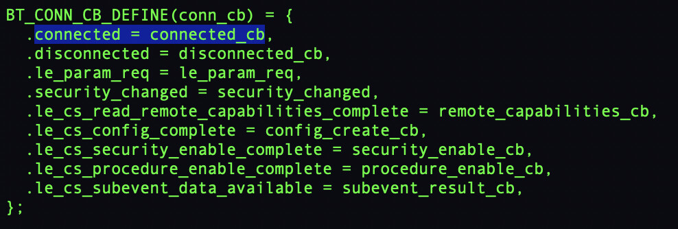

I thought maybe there was maybe a filter that I needed to double check. Like the UUID or the name of each device? I didn’t change those at all.
It’s stuck on the connected callback never happening, which isn’t surprising given the situation in general. Again it seems like the initiator is maybe filtering out the reflector? Or the reflector isn’t set up correctly for some reason. I’ll go lot that side on the mac to see
