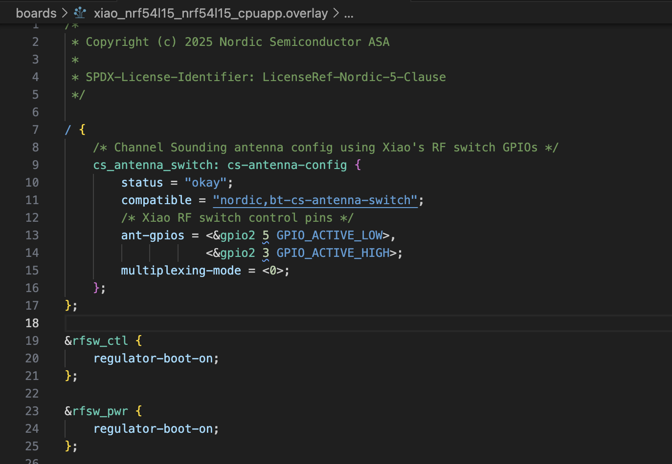

Introducing an updated Sample set for Xiao nRF54L15 / and NRF CONNECT
If I put back the original overlay file, it builds and when I flash I get the instant bus fault
