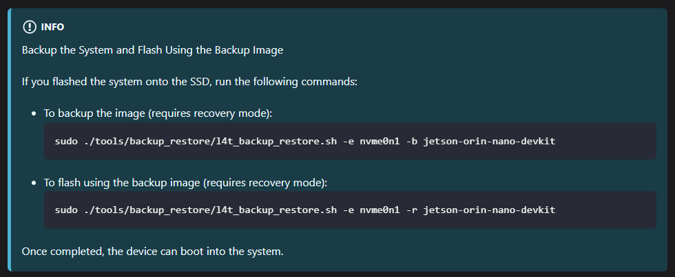

I am trying to install a batch of Jetson Orin Nano 8GB with A603 carrier board, using the backup and restore functionality briefly described on the wiki:
I have JetPack 6.1 installed.
Both the backup (first device) and the restore (on a second device) are successful.

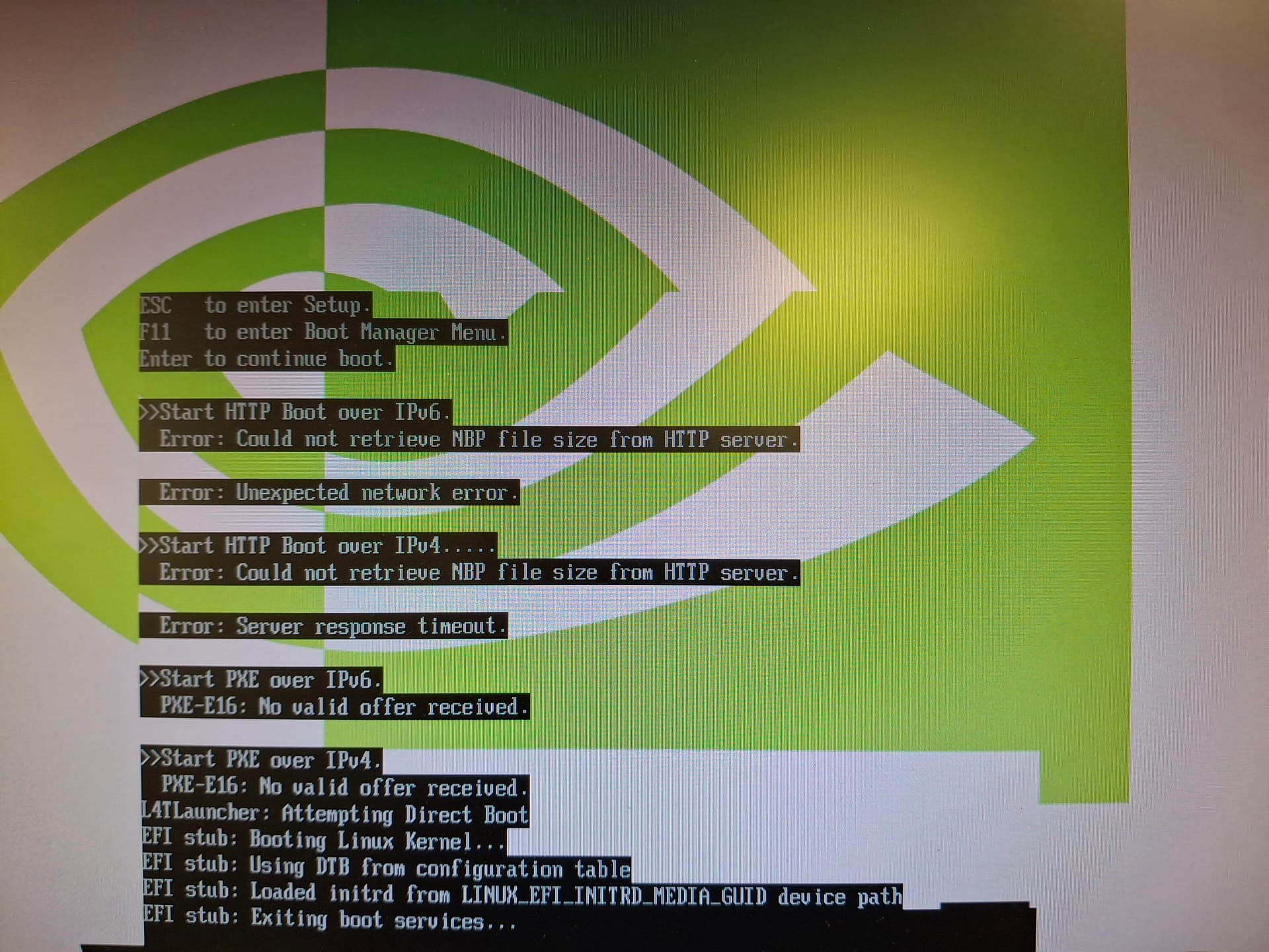

But booting the second device takes very long and shows some errors:
So I have a few questions:
- Is backup and restore the proper way to install a batch of Jetson Orin Nano 8GB with the A603 carrier board?
- Why is the second device not booting properly?
- Are there other things that might not work properly on the device installed by restoring the image?
