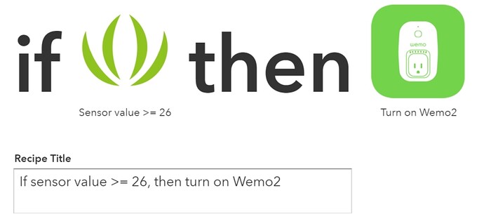

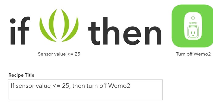

My previous posting used Node-red for the Thermostat. Here is the same thing but using IFTTT. A thermostat does not need fast reaction times so the high latency of the IFTTT server is not normally a problem but it can take minutes! In this example I have created two recipes on IFTTT - one to sense the Grove Temperature at or above 26 degrees C before it switches on the fan by a Belkin Wemo wifi power switch. The other switches off the fan at or below 25 degees C. This is a good method for beginners but you will soon out grow this method as the response times are too slow or may not happen at all if IFTTT is severely congested.
