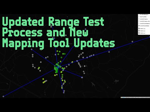

this image shows you a good example of the range of “line of sight” on the ground in urban areas
my device was near ground level riding in a car window looking out
I have no idea where the green node is… it is possable this node was high in a building… maybe a hotel… in this area i would assume no higher than 5 story or 15 meter off the ground
the ping went from my tracker 1000-E and double hopped … first to the green node… then hopped to the red and blue nodes, separatly, then acknowledgement back to the green node and then to my tracker
The land in this area is otherwise completely flat
I estimate the radius of the green node circle is approximatly 2-2.5 miles
