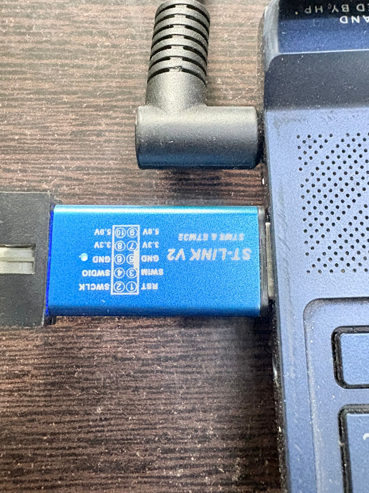

is we need to give 3v3 supply even though we give power by usb when flashing @msfujino

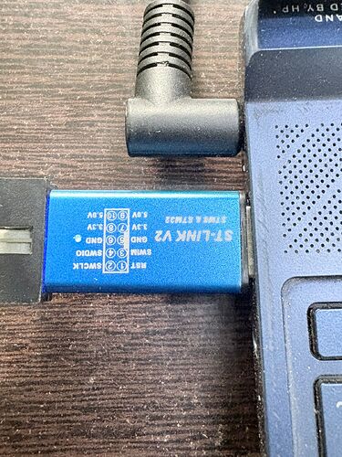

Please show me a photo of the STLink you’re using and its documentation.
You mentioned using an original STLinkv2, but from the photo, it appears to be a Chinese clone.
The function of the 3.3V pin differs between the original and the clone. On the original, it’s an input pin that senses the target’s power supply voltage. On the clone I use, it’s an output pin that can also supply 3.3V to the target.
So, which STLink are you using?
i am really sorry for my information i am using clone stlink
Judging from the photo, I believe it has the same functionality as STLink I’m using. Therefore, you don’t need to connect anything to the 3V3 pin.
If you want to try it, you can also stop powering it from USB and instead power the 3V3 pin from STLink’s 3.3V output.

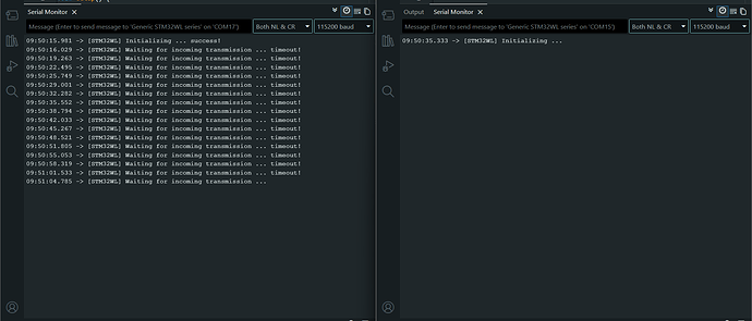

hello.. i had a similar issue when trying to code wio e5 mini boards for transmission and receiving.. i had initially intended to set a single master and 3 slaves which would send data to the master ..whilst doing so, i found only the master and one slave working properly.. the 2 other boards did not transmit the message..then i tried to remove the master and tried to implement a simple transmission and receiving between 2 modules.. in the same.. out of the 4 devices .. only 2 worked properly and the previously not working slaves did not work as either transmitter or receiver.. could there be any issue with the hardware.could someone help me out
The attached hex file is a sample I’ve confirmed works in my environment.
Please upload it to your non-functioning Wio E5 mini and try it out.

I uploaded your transmitter code to the non working modules and the receiving code onto the modules that work and this is what i have gotten.. the initialization does not happen.. even when i upload the receiver code onto the non working modules.. the initialization does not happen
