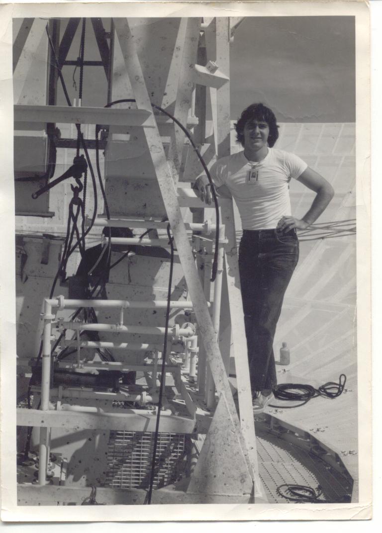

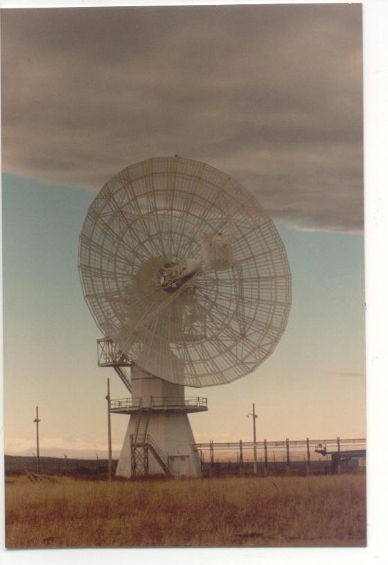

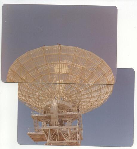

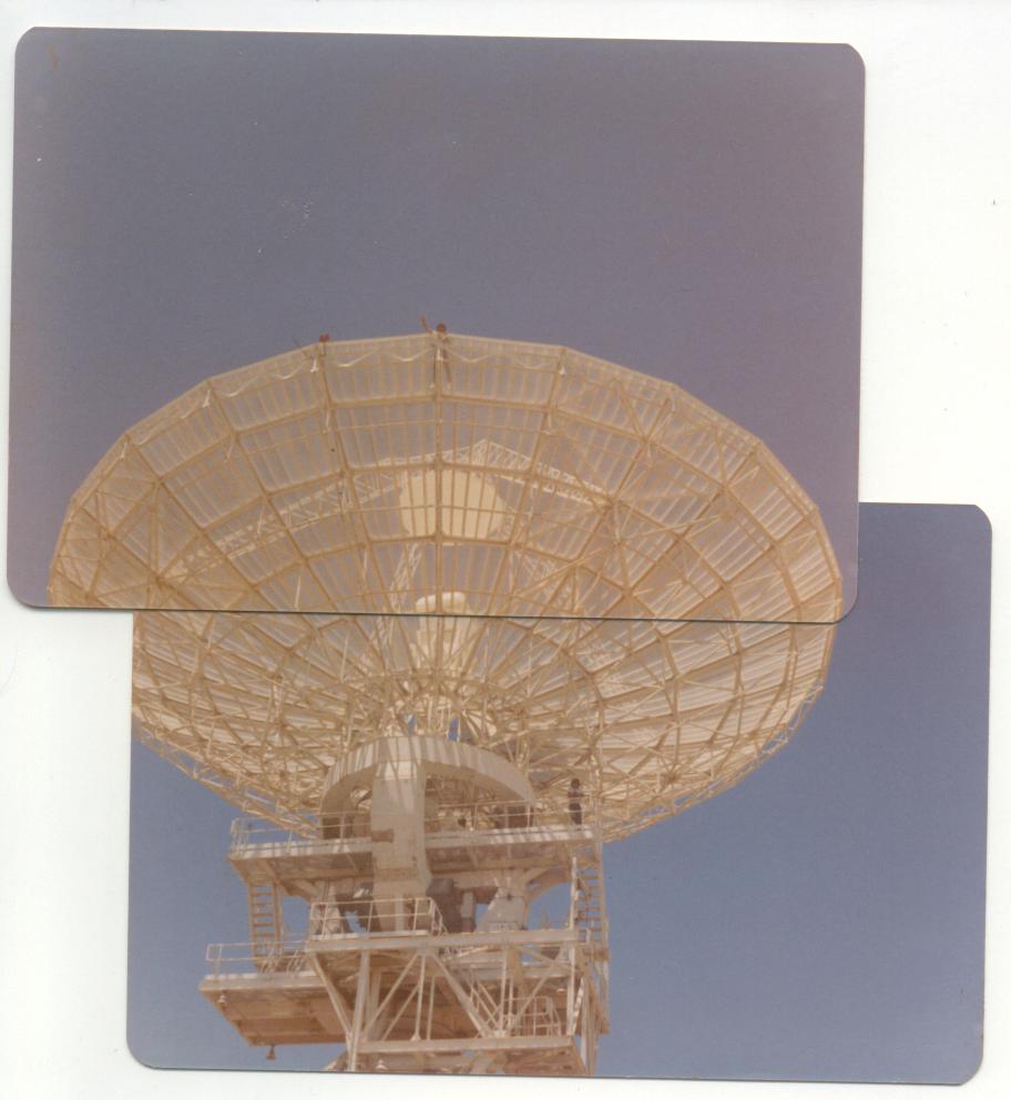

not like measuring the POWER of this BABY
first pick (wineglass position ) I’m in two places at once ZOOM… LOL
Feed horns were as big as me, I could crawl inside the Waveguide.. :stuck_out_tongue_winking_eye:
