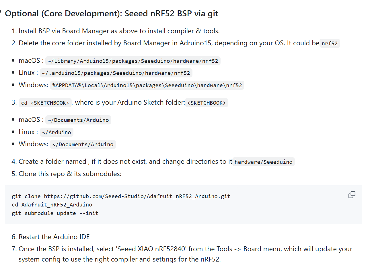

I can’t download Seed NRF52 Board online in Arduino, is there any way to do it offline?
Check out the Github for Seeed Studio, should be there.
I am sure find the way about how to do that ,this is the link: Seeed-Studio/Adafruit_nRF52_Arduino: Arduino Core for Seeed nRF52 Boards. But it asked me to " 1. Install BSP via Board Manager as above to install compiler & tools." take the first step.
I find it strange because it is precisely I can’t download online that I thought of the way to download offline
