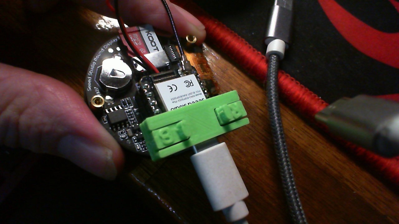

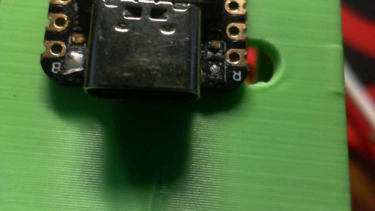

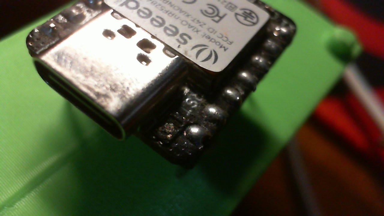

So it’s an occasional problem with the smaller XIAO 's with the small buttons, here is a picture of an nrf and an S3 that the reset button has left the CHAT
The boot button still works, So I fitted it with a set of the BIG buttons (3D-Print) and hold the boot button on the big set and plug in the USB cable (at the same time) and I can still program it. The other NRF52840 that one I use exclusively in the XIAO Dev_Expansion board (has its own reset button)
they are mechanically broken, so replace or work around add external shunt push button. ![]()
GL
PJ ![]()
Typically to enter bootloader mode (for programming) You hold the BOOT button down, while pressing and releasing the reset button, then let the boot button go.(last) FYI, some cases the commport number may change. YMMV Once connected you r good to go!
