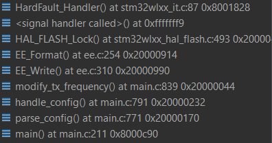

- Erasing the page 127(which I use for writing the values), writing the values to it / reading the values from it any number of times worked perfectly.
- Read the values from page 127 and then erasing the page and writing to it. I get hardfault error everytime.
if I erase the page 1st and write to it, then there is no use of storing in it. So, If I read the flash, I’m not able to write to it.
I have also moved all the functions used for writing into flash to RAM by adding attribute((section(“.RamFunc”))) in function definition so that there won’t be stalling of CPU. I have checked in disassembly while debugging that all the related code is running from RAM.
I get hardfault error while HAL_FLASH_Unlock() after erasing the page. Is there any other configuration I need to do for using flash as eeprom.
