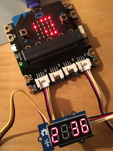

Now if I also load the Grove extension package I would expect to show the temperature and the pressure on the 4-digit display. But unfortunately only the temperature is displayed correct (e.g. 24°C). The pressure won’t show correct on the 4-digit display: only two digits are displayed. Either the last two or the first and the last one. Pressure is divided by 100 and ‘floored’ so it is hectopascal. Currently 945 hPa and the 4-digit display shows “__45” or “_9_5”.

just found out that the number 9 won’t be displayed on the 4-digit grove display at the 3rd position from right.
It all started with the barometer sensor BMP218 connected to the grove shield with a microbit inserted. When finally loading the appropriate extension the temperature and barometer values are displayed on the 5x5 display of the microbit as one would expect.
Connecting the 4-digit grove display just shows the temperature values correct 24°C but not the barometer value which is 945 hPa.
Trying various possible causes I found that if at the third position from right the number 9 should be displayed it won’t. To make sure I just set the variable to fix value 2936. And it will be displayed as “2_36”.
Switching from P1 to P2 has the same effect. And since I have a second 4-digit display and this one behaves exactly same way I assume that 4-digit displays are ok. But this is very strange to me.
