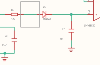

In the “Grove-Capacitive Moisture Sensor” schematics, a capacitor is drawn instead of a resistor R7=1M. This is incorrect, the resistor R7 should be drawn. And one more thing - the capacitive sensor is drawn as a rectangle. But this rectangle should have an electrical connection to GND to get a capacitive sensor.
