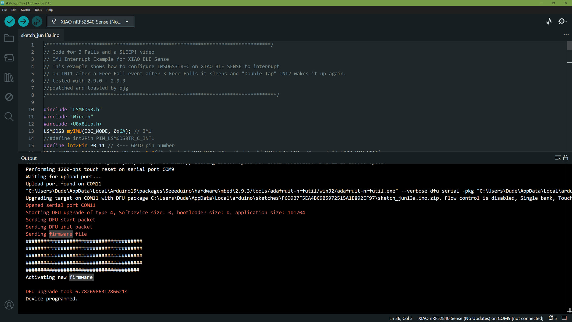

I used the 'MG24 for a similar project (XIAO MG24 doesn’t have an IMU interrupt :thinking:), but just polled at 50mS - gives about 3 months battery life.
So , you should probably try it first , I just did it compiles, builds perfect and runs too. I don’t know what you have got going on , but it’s definitely between the keyboard and the floor forsure…
ip created at C:\Users\Dude\AppData\Local\arduino\sketches\F6D9B7F5EA4BC9B5972515A1E892EF97/sketch_jun13a.ino.zip
Using library Seeed Arduino LSM6DS3 at version 2.0.4 in folder: D:\Arduino_projects\libraries\Seeed_Arduino_LSM6DS3
Using library Wire in folder: C:\Users\Dude\AppData\Local\Arduino15\packages\Seeeduino\hardware\mbed\2.9.3\libraries\Wire (legacy)
Using library U8g2 at version 2.36.18 in folder: D:\Arduino_projects\libraries\U8g2
Using library SPI in folder: C:\Users\Dude\AppData\Local\Arduino15\packages\Seeeduino\hardware\mbed\2.9.3\libraries\SPI (legacy)
"C:\\Users\\Dude\\AppData\\Local\\Arduino15\\packages\\Seeeduino\\tools\\arm-none-eabi-gcc\\7-2017q4/bin/arm-none-eabi-size" -A "C:\\Users\\Dude\\AppData\\Local\\arduino\\sketches\\F6D9B7F5EA4BC9B5972515A1E892EF97/sketch_jun13a.ino.elf"
Sketch uses 101696 bytes (12%) of program storage space. Maximum is 811008 bytes.
Global variables use 46072 bytes (19%) of dynamic memory, leaving 191496 bytes for local variables. Maximum is 237568 bytes.
Performing 1200-bps touch reset on serial port COM9
Waiting for upload port...
Upload port found on COM11
"C:\Users\Dude\AppData\Local\Arduino15\packages\Seeeduino\hardware\mbed\2.9.3/tools/adafruit-nrfutil/win32/adafruit-nrfutil.exe" --verbose dfu serial -pkg "C:\Users\Dude\AppData\Local\arduino\sketches\F6D9B7F5EA4BC9B5972515A1E892EF97/sketch_jun13a.ino.zip" -p COM11 -b 115200 --singlebank
Upgrading target on COM11 with DFU package C:\Users\Dude\AppData\Local\arduino\sketches\F6D9B7F5EA4BC9B5972515A1E892EF97\sketch_jun13a.ino.zip. Flow control is disabled, Single bank, Touch disabled
Opened serial port COM11
Starting DFU upgrade of type 4, SoftDevice size: 0, bootloader size: 0, application size: 101704
Sending DFU start packet
Sending DFU init packet
Sending firmware file
Activating new firmware
DFU upgrade took 6.782698631286621s
Device programmed.

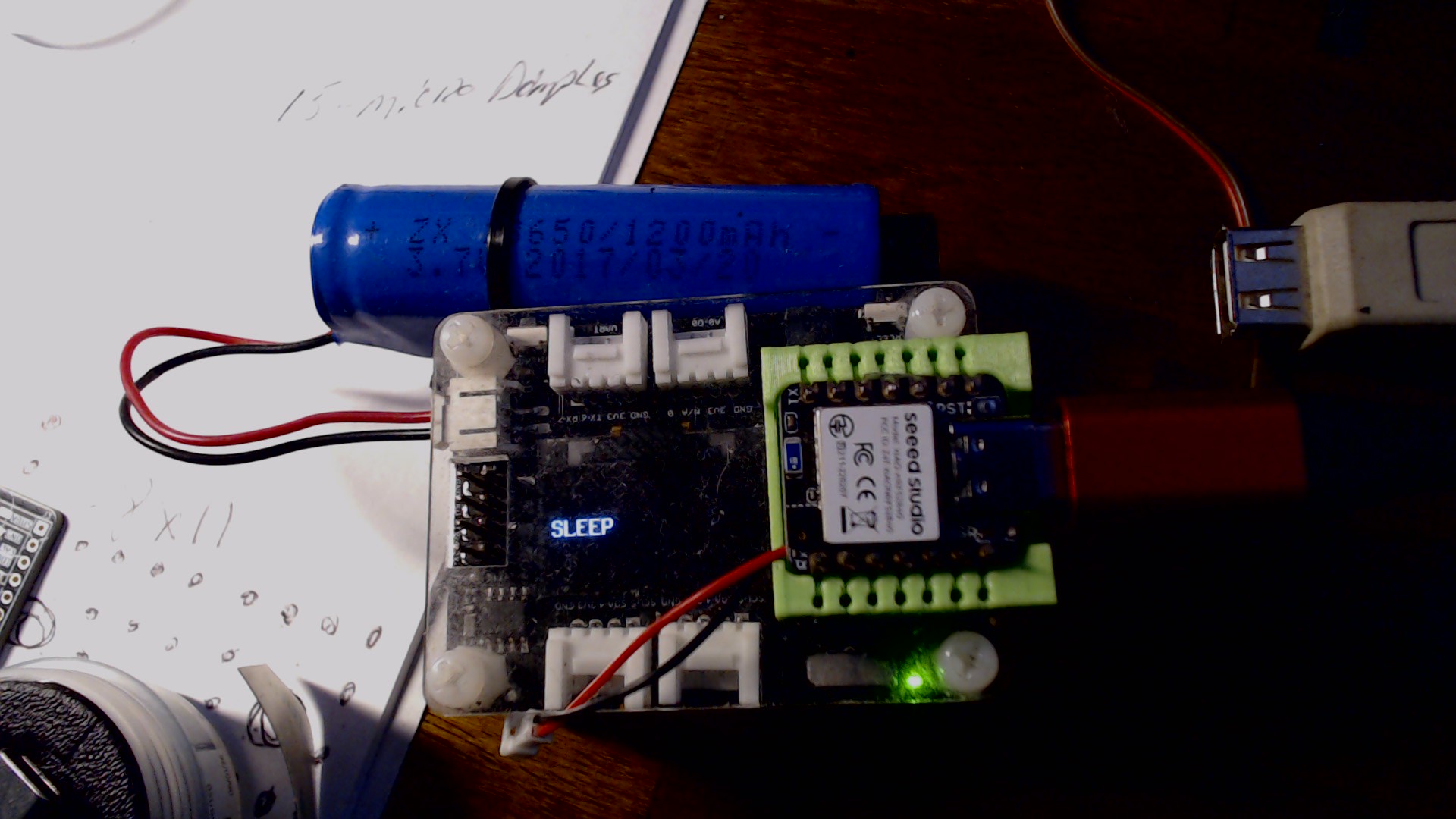

Here is the same code as the demo, (that runs) :grin:
but adjusted for the Tilt paradigm, There’s lots of good research on the subject. (this meets your needs better IMO) than a bunch of theory, and just more jiberish.
Even adding your comments to the LLM, I get better replies’ than what has been posted thus far. IMO/
for example , You will be able to follow along but the peanut gallery will struggle.
HERE is the Prompts and resultant reply.
But first the code
:grin:

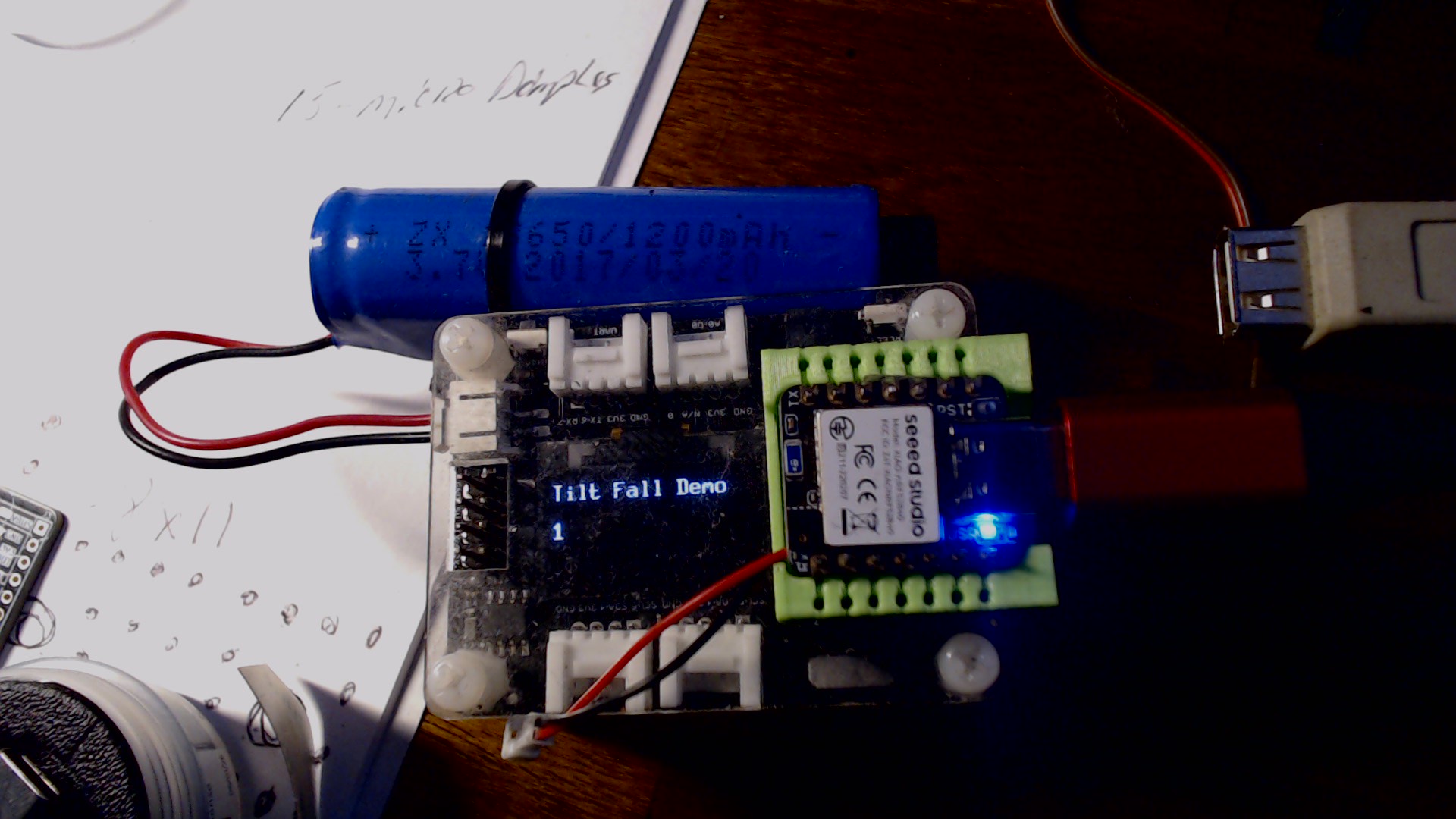

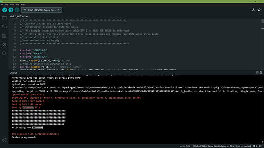

the reconfigured for tilt,
:v:
I’m getting a “403” error, Standby …
sketch_jun13b_tilt_ffal.zip (2.4 KB)

You see the photo’s . Drop with tilt is the key :+1:
