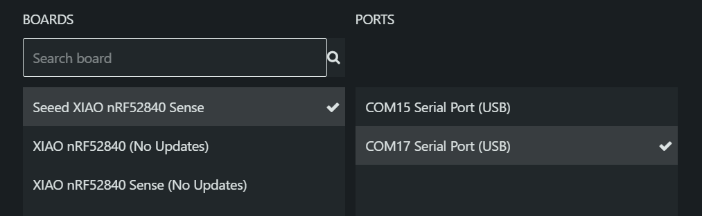

I’ve selected the nRF52840 Sense as per the instructions

In Arduino IDE, check:
Tools —> Board
Are you using:
Seeed nRF52 Boards —> XIAO nRF52840 Sense
or are you using:
Adafruit nRF52 Boards —> nRF52840 Sense
or another package?
The EN05 support was developed around the Seeed nRF52 board package.
