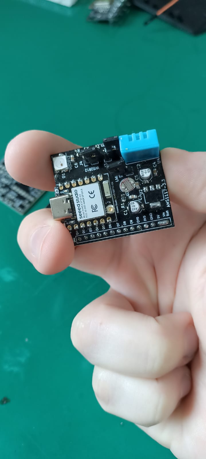

My process is: 1. Prototyping of single functions/elements on breadboard with code-testing. 2. Putting it together on Perfboard 3. PCB Design e.g. Easy-EDA.
On Perfboard and on the PCB a cutout under the ESP32C6 is useful to get access to the pins on the backside, which are not useable in the FritzenLab-solution.
You can follow this design for a reference. Demo board XIAO METER for SEEED STUDIO XIAO SAMD21 - Share Project - PCBWay
This is based on XIAO SAMD21. However, you can make a similar design using XIAO ESP32-C6. The board has a button,a Slide Switch and an OLED I2C Display.
