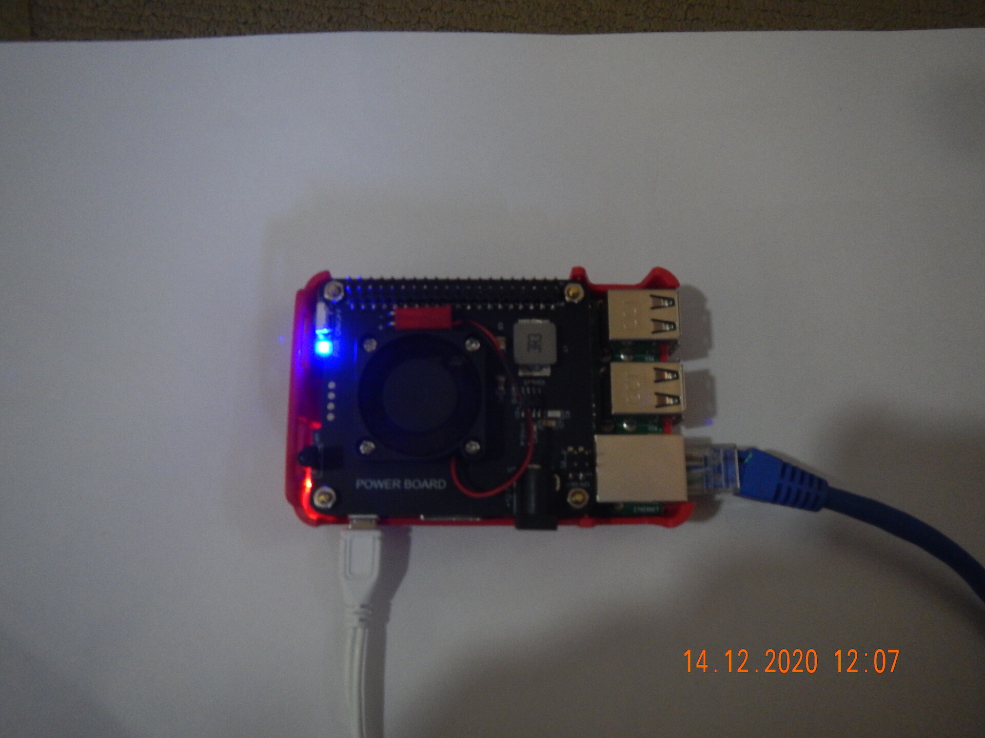

Unfortunately unable to get it to operate
Supplying 12 volts and can measure on the docker pins so know is getting
to the board
Following the instructions from -
Powered the PI from normal supply and updated the driver -
https://raw.githubusercontent.com/geeekpi/dockerpi/master/powerboard/install.sh
The PWR LED does it come on when feed with 5V from the PI but not when
fed with 12V
Measuring with a multi-meter, I can see 12 volts on the 12v riser pins
and on pin 8 of the TPS54527 so know its is being
fed. Nothing on the outputs of the TPS54527.
I cant measure any voltage at the switch but can confirm it is
operational as short when pressed and open when not.
The power is from a regulated 12V 30A power supply so able to power the
unit.
Please advise if I have done anything incorrect or the product is faulty?
Please note this product is purchased from Pakronics , Australia who are official distributor of Seeed.

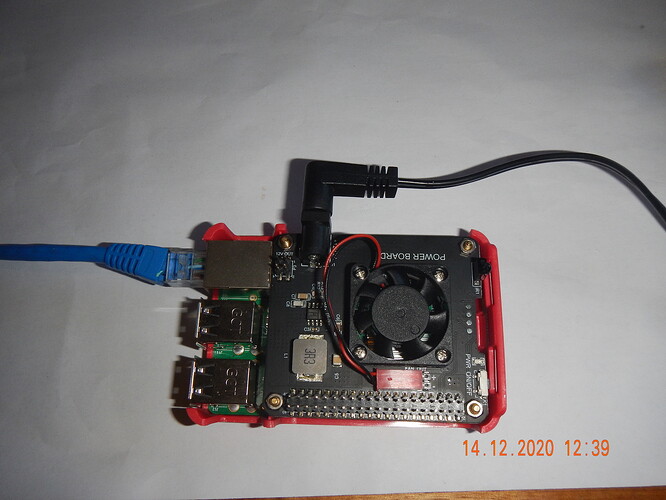

attached pics of the device mounted on the Pi3B.
Cheers!
