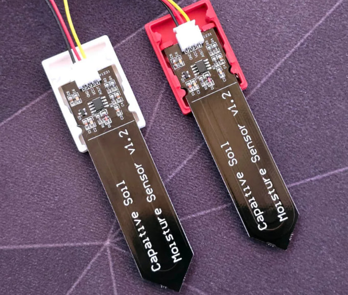

Then a 3D Printed enclosure filled with Silicon Sealant.

Hey, thanks for your detailed answer. Specially, the 3D printed case idea looks very wise. It is important to save the electronics from water. May I know where you printed it from?

https://makerworld.com/en/models/846431-case-for-capacitive-soil-moisture-sensor-v1-2-v2?from=search#profileId-793598
