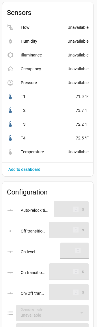

Now for a little refinement. In Home Assistant I see “sensors” for flow, humidity, occupancy and more. There are also many control, configuration, and diagnostic items which either don’t exist or I don’t need for this project.

Below is just a part of the HA device page. T1 through T4 are the actual things I want. I would love to not see most of the greyed-out items.

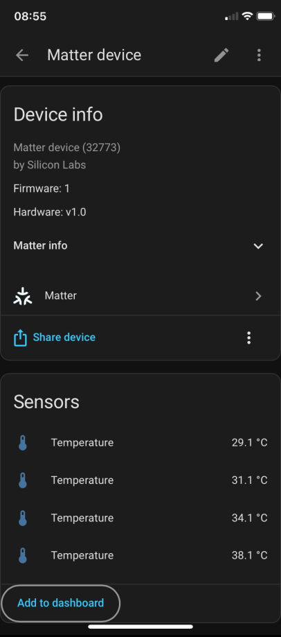

I have just created the 4 x Temp Sensor and added to my HA Dev System. All is OK?
Perhaps remove the device, clear the credentials and do a factory reset, before rejoining HA Matter fabric?

That looks great. I did fail to mention that this was the MG24 Sense, not the plain MG24.
I will try starting over as you suggest and I will report back. My only concern is that Home Assistant doesn’t like to completely forget things, so I may not get as clean a start as it might seem.

Not sure that the MG24 Sense version should add Matter Endpoints without them being implemented somewhere on the device?
It could be possible that using the same device (eg MG24) for multiple Matter “projects” leave some “straggling” information on the Matter Server - but I haven’t really come across that. Key is to ensure a complete removal of a device from Matter when replacing it with another different device type.

That did it! I have no idea how all those extra entities appeared. I had previously set up that device as a tilt sensor. But the other things were never used.
Now with a clean start it looks great.
Thank you very much for prodding me in the right direction, even if the only solution was “start over”!
