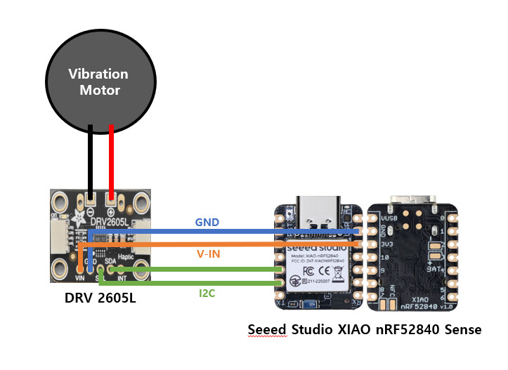

If I solder as shown in the picture and run the Basic code provided in the library, will the vibration work smoothly?
Power supply is connected to the PC via a C to C cable.

SO , Yes… That should work fine. Both are 3.3 v devices. as long as the vibration motor is the right range for the board . everything should work. :+1:
Thank U, I did as you said and it works perfectly.

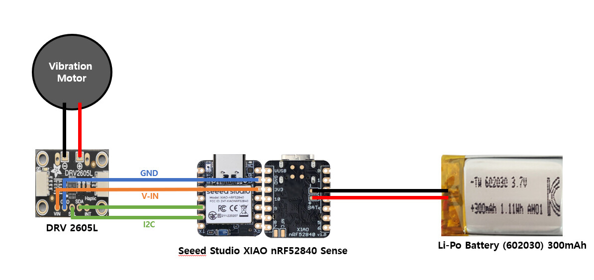

But if I connect it to the lithium polymer battery instead of the PC with a C-to-C cable, can I turn it off?
If I connect it with a C-to-C cable, I can simply unplug it, but I plan to solder the lithium polymer battery.

You would need a switch, or Arduino Code to Deep sleep it and only wake up with a press of the reset button or motion in the case of a Sense version of the MCU…
Most folks go for the switch

I will choose the switch and this is my circuit diagram, where should I place the switch?
