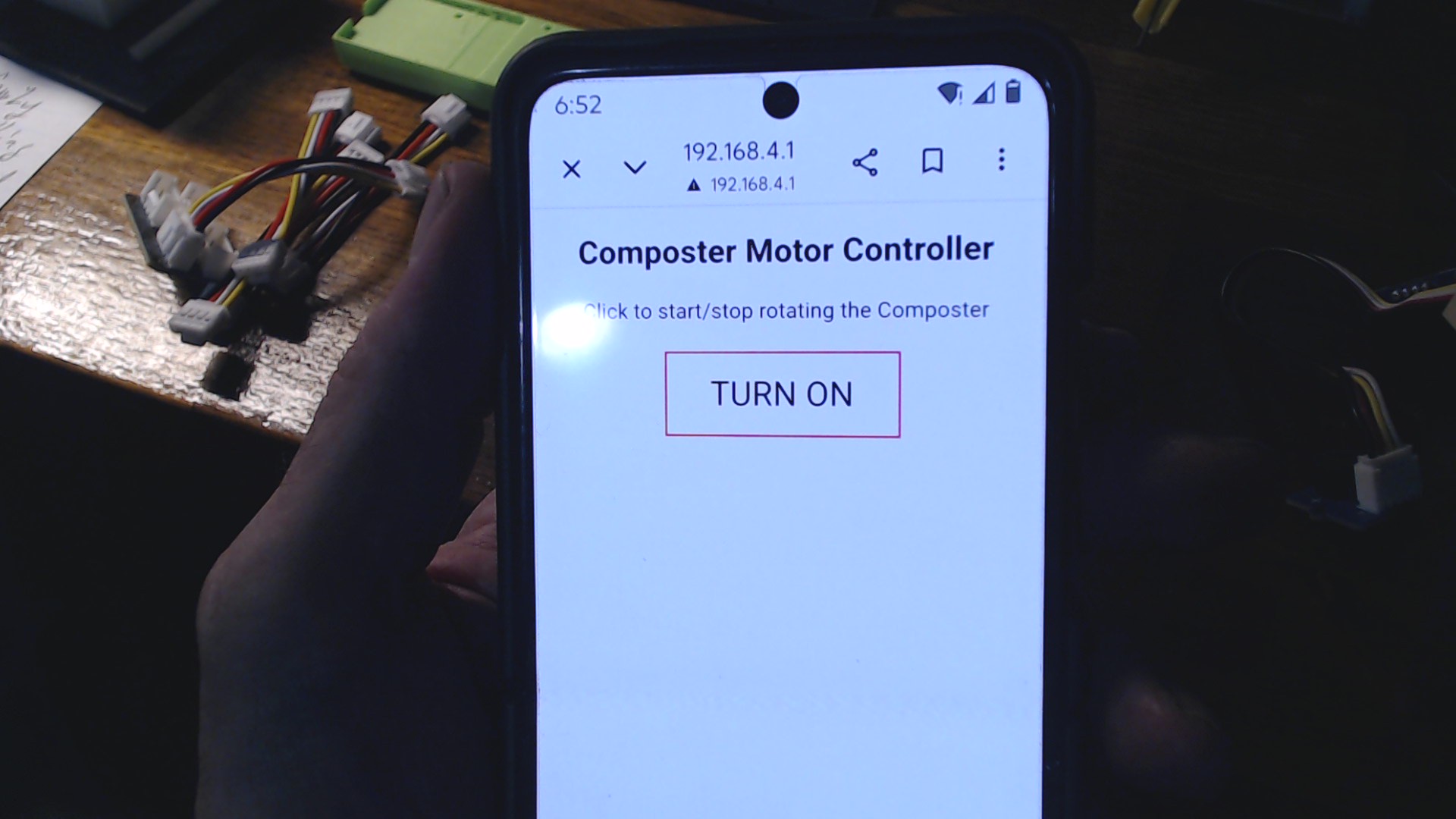

So I was able to download the ino and try it , same as you.
I see a couple issues, I refactored for the no spam to console and added some cleanup.
On my MOT Razer it looks good :+1:
I get this serial output.on boot.
ESP32 Access Point Mode
SoftAP started successfully
Connect to IP address: 192.168.4.1
HTTP server started
Upon connecting to the composter with password, (no internet NAG) select options on mobile to continue to use the connection anyway , and I then Browse to the IP
and Bobs your Uncle.

Appears to work well…with the edits i’ve made. :crossed_fingers:
