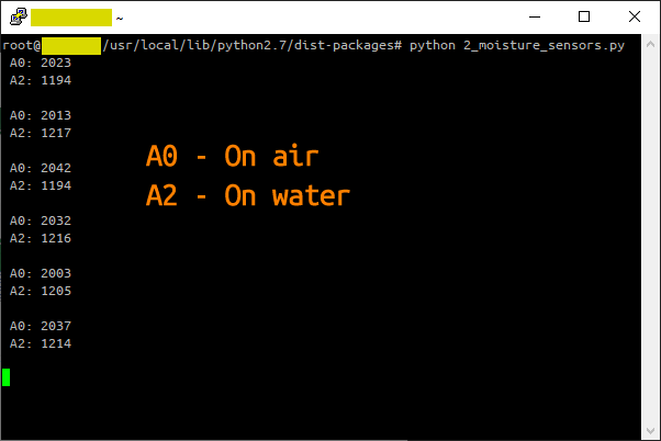

But my readings are around 2000 open air (A0) and 1200 with the sensor in water (A2).
My script with the readings from the two sensors. The data is the same with grove_moisture_sensor.py
I’ve seen other users in the forum with the same problem, but no solution. I’ve tried all combinations of analog ports with no other sensors in the board with no different results. In fact if i unplug the sensors, the readings in the ports are always around 2000.
