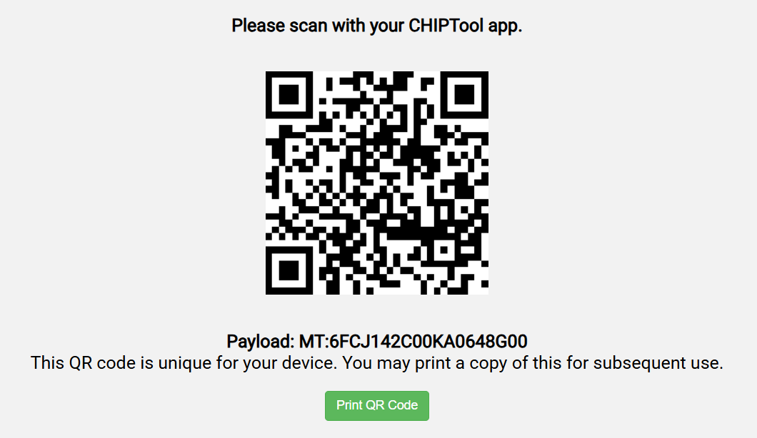

Connect a Serial Terminal (eg PuTTY) to the XIAO MG24 serial port.
Click the run button to start the debugger.
The following messages are sent…

[00:00:00.490][info ][SVR] SetupQRCode: [MT:6FCJ142C00KA0648G00]
[00:00:00.490][info ][SVR] Copy/paste the below URL in a browser to see the QR Code:
[00:00:00.490][info ][SVR] https://project-chip.github.io/connectedhomeip/qrcod e.html?data=MT%3A6FCJ142C00KA0648G00
[00:00:00.491][info ][ZCL] On/Off ep1 value: 0
[00:00:00.491][silabs ]App Task started
matterCli> [00:00:30.481][info ][DL] Starting advertising with interval_min=240, intverval_max=1920 (units of 625us)
Connecting to the Matter fabric (network).
From the matterCLI messages select the QRCode URL.
https://project-chip.github.io/connectedhomeip/qrcode.html?data=MT%3A6FCJ142C00KA0648G00
Get the QRCode and using your mobile phone and a suitable Matter device, add your new XIAO MG24 Light to your Matter network.
The XIAO MG24 On-Board LED will be affected by the Matter Device On/Off changes.
