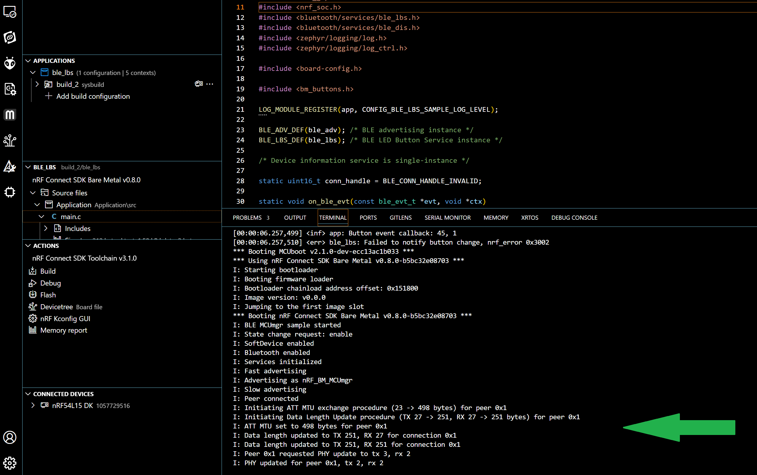

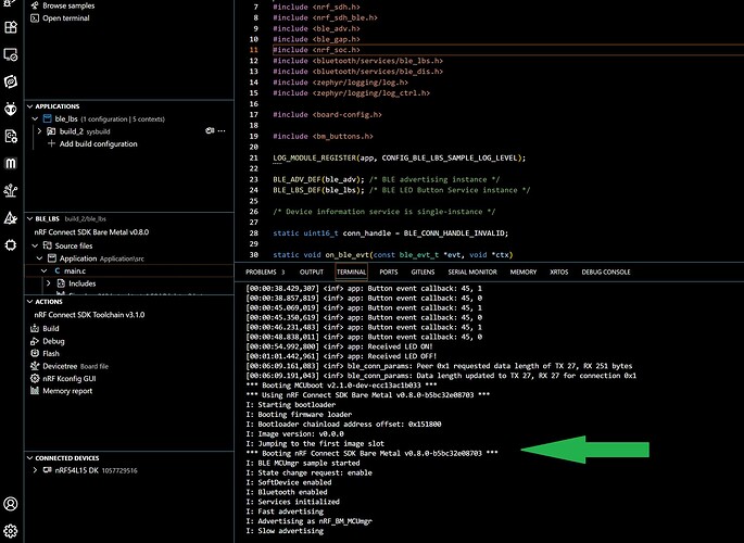

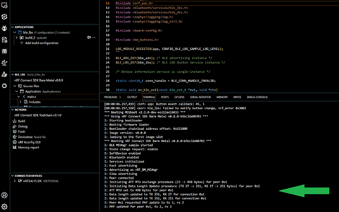

I was able to duplicate the Example No problems :+1:

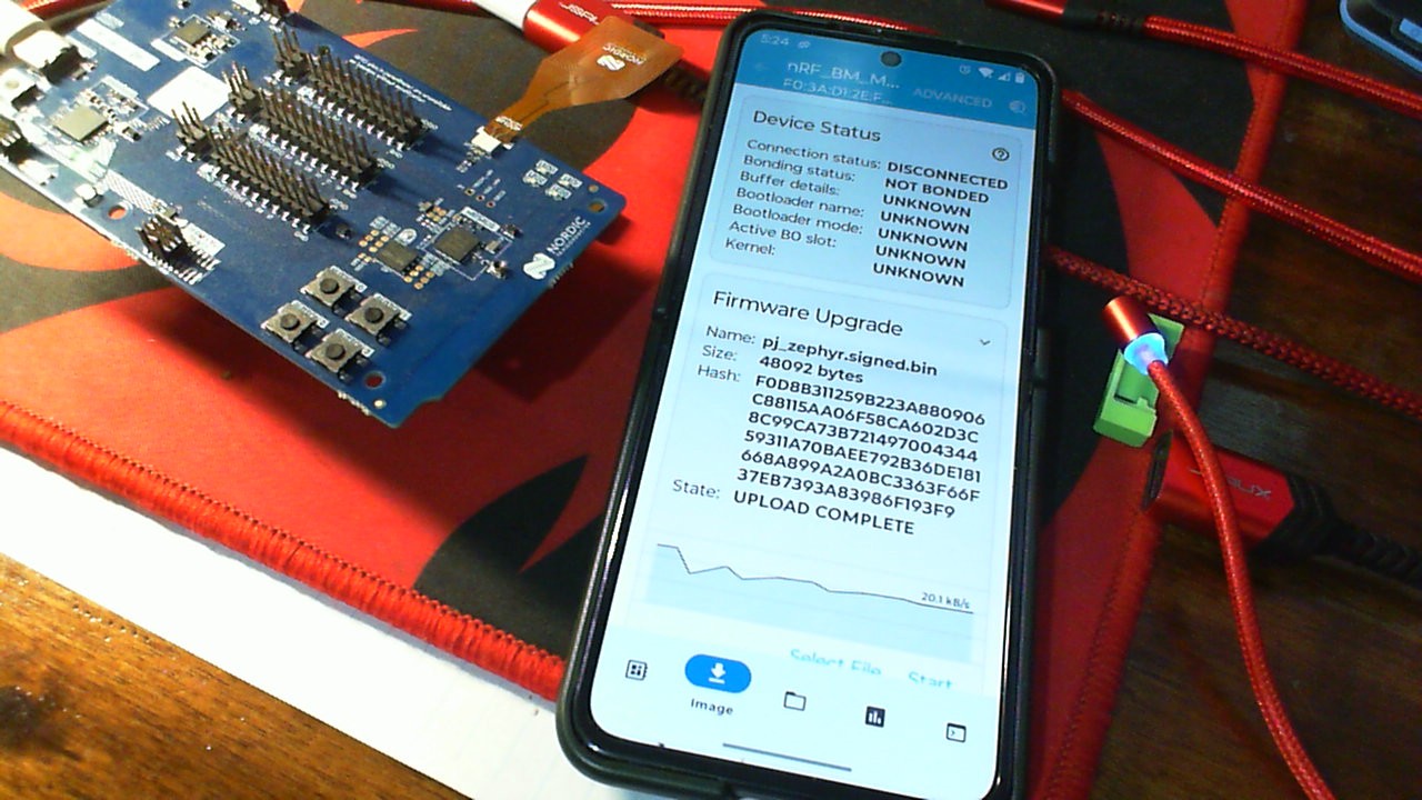

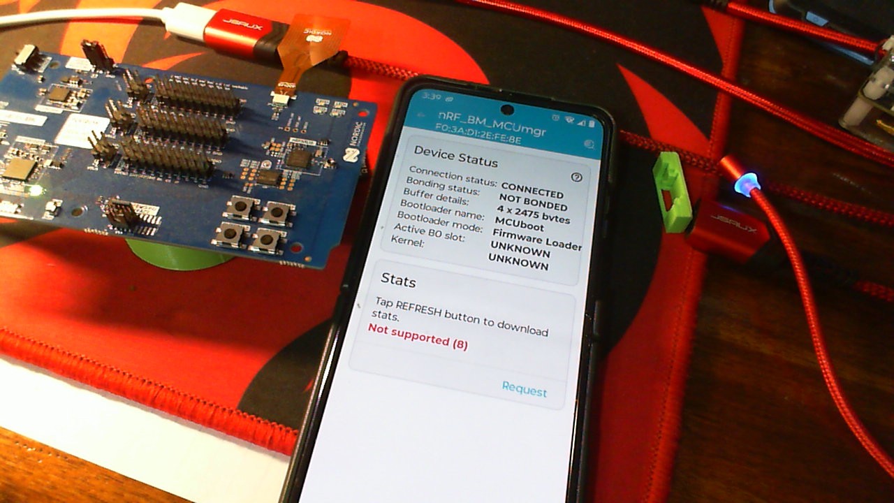

Ditto for the DFU, BootLoader mode…
Seeed needs to make this standard IMO.

Like butter!
