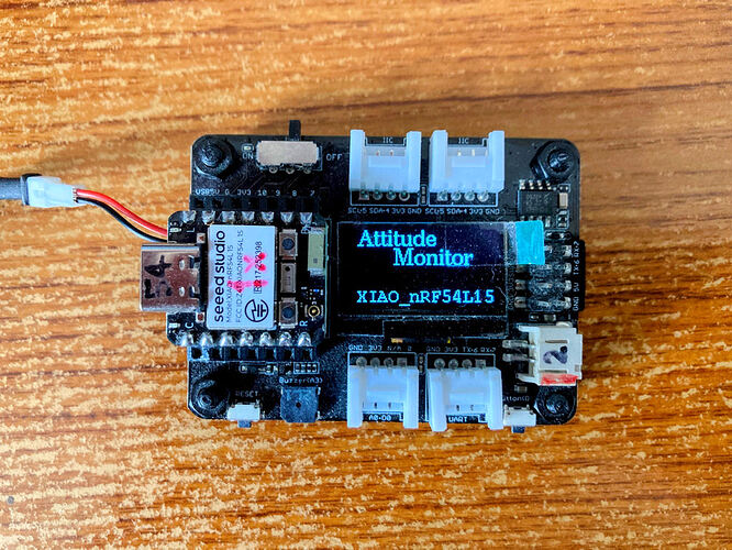

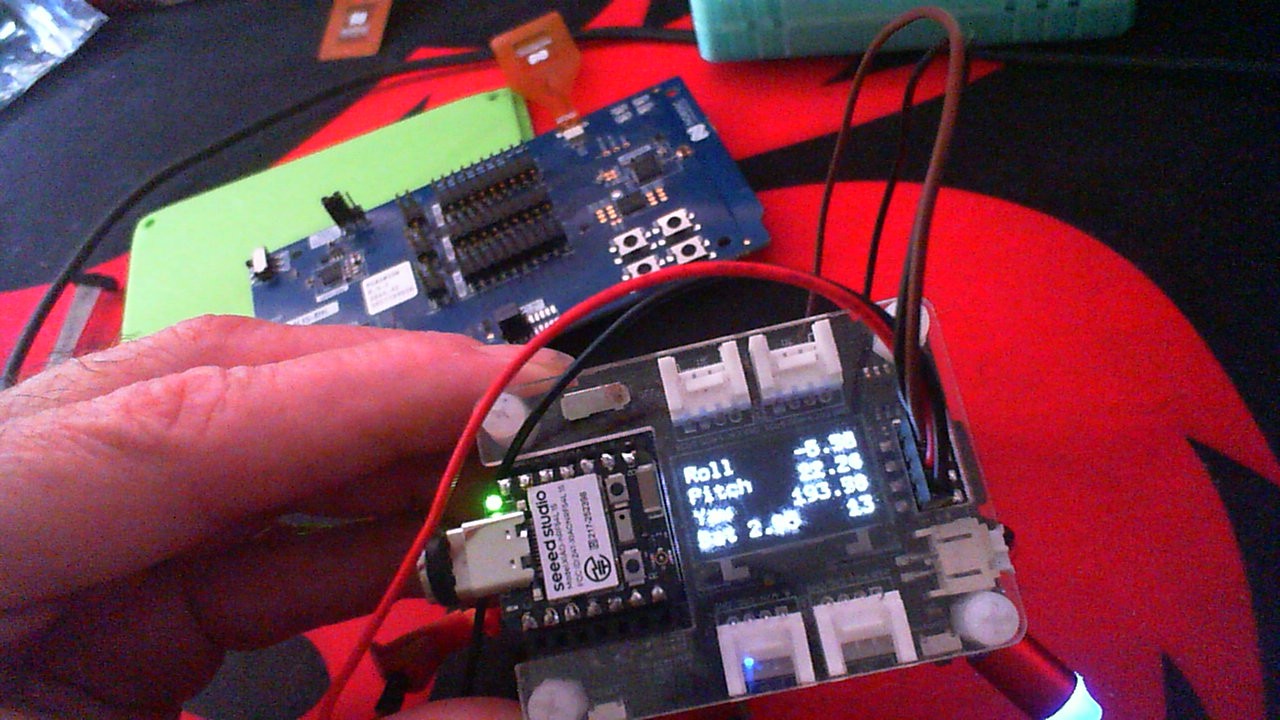

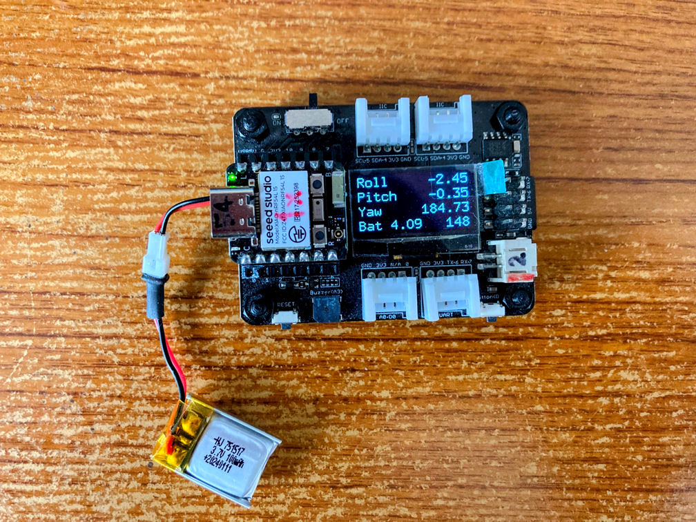

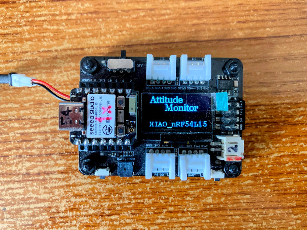

I’ve gotten a bit more comfortable using the development tools, so I built an attitude monitor using the XIAO_nRF54L15_sense and XIAO expansion board for practice. For the battery voltage and IMU, I referenced the sample project. For the rest, I reused Arduino libraries: the Madgwick filter to convert acceleration and gyro data into attitude, and the U8g2 driver for the SSD1306.

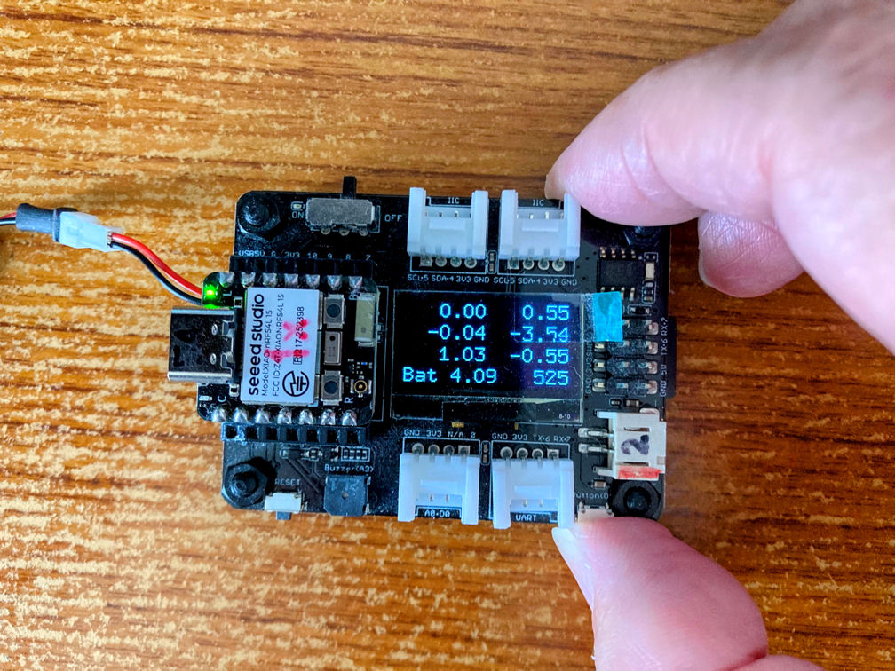

Using the U8g2 allows for various fonts like the ones shown on the title screen. Pressing the user switch on the expansion board toggles between displaying attitude data and the accelerometer/gyro data.
I hope this serves as a useful reference for anyone interested.

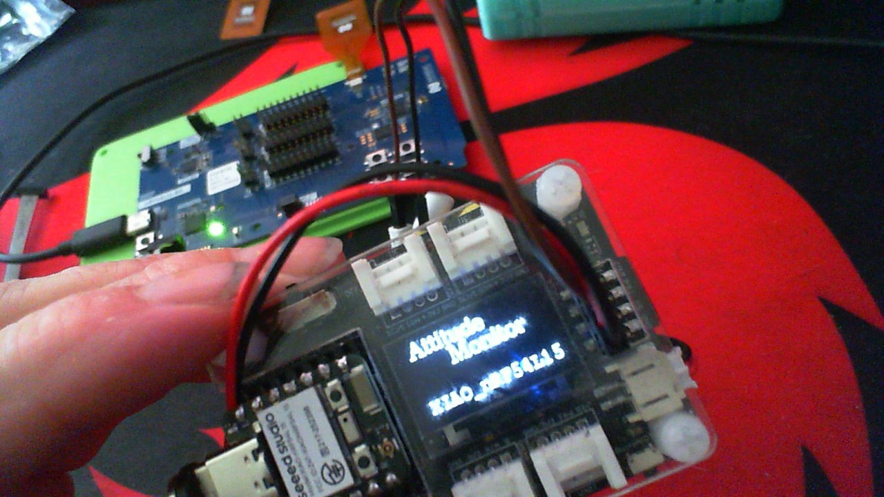

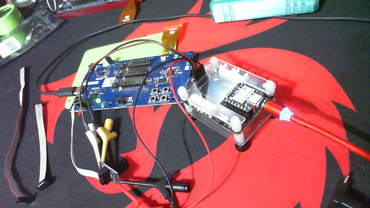

I did manage to Lock one up and West would’nt and OpenOcd could’nt access some base memory address, (i’ll post a complet info onit ) but sufice to Say I had to connect it to the nrf54L15_DK (EXT) SWD to Get it back. After I wrote a known good merged.hex to it all is well and using it again. (no bricks yet)

Had to switch to a shorter cable to get it to read the Xiao with the internal JLink on the DK board.

and after about 30 or so( a days worth) I would say I got an error, that OpenOCD couldn’t write to a memory location after a halt command, I went XIAO>SWD>JLINK>DK_Board< and got it back. I will experiment to see if I can reproduce it with the code I was using, was for the round-display.
